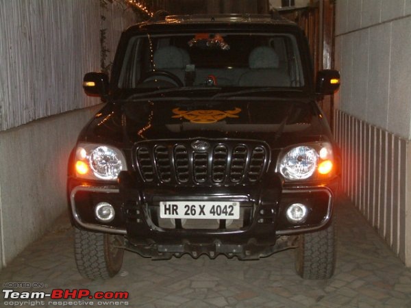

AFAIK, no better option is available. I've been looking for long for electrically controlled side RVRMs but all in vain. And as far as side indicator integrated RVRM is concerned, there is nothing of that sort. You get a cover over the mirror unit that has indicator lights and is stuck to it using double-sided tapes..
Indicators on side RVRM of my Scorpio
