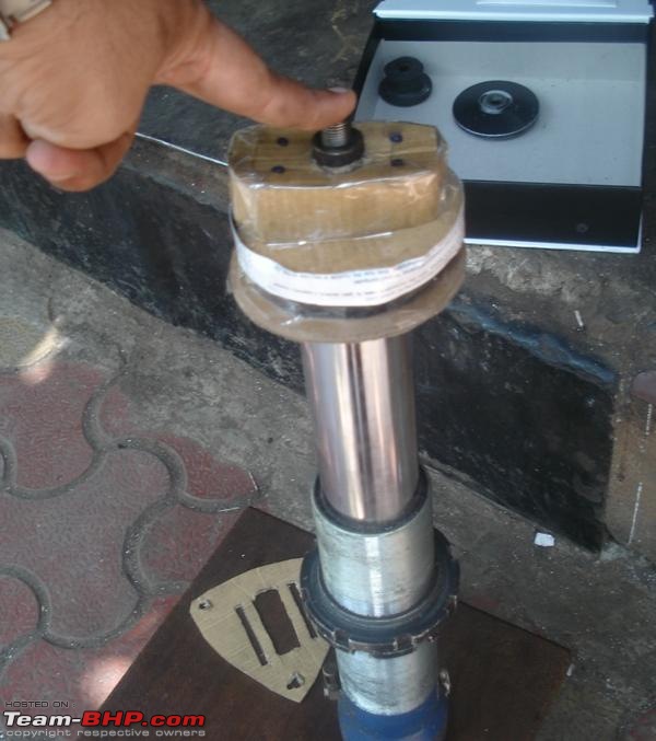

The work on my custom Top section of DMS coilover has just begun, since i had bought this stuff used, it didn't came with top section & bearings, hence i thought it would be best to customize the setup with adjustable Camber plates on top. To begin with 1st i took out used top section of OHC Suspension, disassembled it completely,
it looked something like this.
As you can see from the pic the bearing sits between the plate which mounts on to chasis & top section of spring assembly holder of strut

Since the custom fabrication is on billet material, i thought it would be better to make some prototype which i can show as sample, so the turner gets an idea of what actually i want, hence the sample was made out of cardboard with cuts approximately done, the measurements aren't accurate but this was just to give an idea to the turner that how it has to be made.
The sample

The Machine work will be a time consuming job, since all the angles & cutting require very precise measurement, will update as things progress.
P.S: any suggestion/recommendation most welcome.
Love the cardboard cut outs Jitu! Good luck!!
Be careful with the angle of the slit for the camber plates if not precise you might face varied toe settings. Am also assuming that you plan to use 4 allen bolts 10 mm.. hope the grade of aluminum is good enough to handle the shearing force of a launch.
I would not recommend using Aluminium for these parts. It will not take the load and as Psycho has mentioned will shear in sometime. Even if it does not shear the camber plate will start to warp in due course of time. I recommend you use SS for these parts.
How will you access the bump and rebound settings if you put in the bottom assembly?
Good work, but again making custom camber plates are a worry. To get the angle correct and ensure both camber plates are exactly the same is painstaking work. If its high grade billet aluminium it should hold. Hoping that things work alright. Are not camber plates available for the honda?
One more thing, do these shocks come with adjustable spring perches?
Yes sir...
That goes without saying ;)
Good effort, but wouldn't it be easier and more reliable to use a ready made aftermerket suspension?
Especially considering that your engine produces close to 4 times the bhp of a stock Indian VTEC.
Shan2nu
The camber plates will work if you make them at least 3/8" thick and out of a grade no lower than 6061-T6. Anything lower than that, and I'd be concerned about fatigue. If you cant get this grade then mild steel is much more forgiving in terms of both machinability and design mistakes.
Make sure the allen-head screws are Grade 12.9 or higher also.
A competent machinist should be able to do a good job without CNC.
6061-T6 is an aerospace grade aluminium. Will be a little difficult to source and will be expensive also. But that is the only grade that will work as mentioned by Ananth.
My personal recommendation is still SS 304.

Originally Posted by vikram_d (Post 1239864)
6061-T6 is an aerospace grade aluminium. Will be a little difficult to source ....
Really? :confused:
I'm no expert about this stuff, but i've used 6061 the most (7075 for one other project that needed something a little better) and i was under the impression that it was quite a commonly available alloy and therefore should definitely be sourcable here.
I wouldn't be suprised if Jitus stock (in the pics) is indeed 6061-T6.
