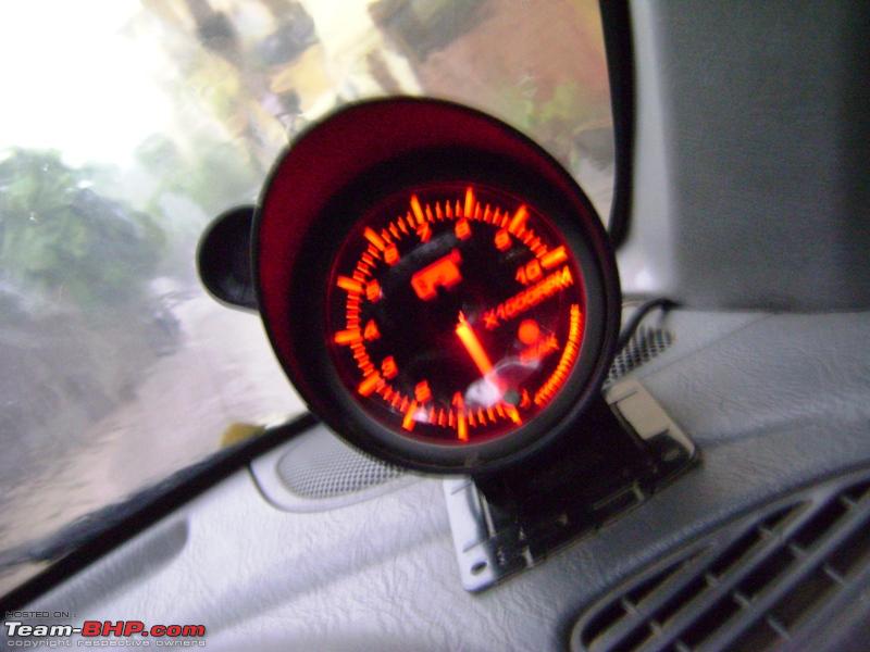

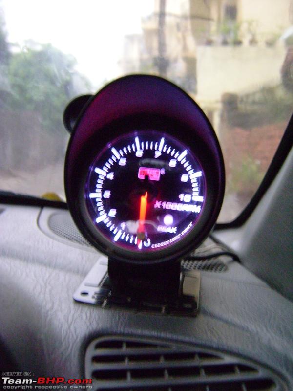

here is a tacho i have in my alto. cast me about 4000 with the shift light. although it does not require a shift light as the meter changes color and beeps at the shift point you set for it. try looking for something similar for your alto.
attaching a few pictures.i dont really like the huge rpm meters. i think they are too big for an alto. sorry about the image quality, phone camera.
bOoM!
Hey. That looks cool, man. devrajman and gpa can try this.
