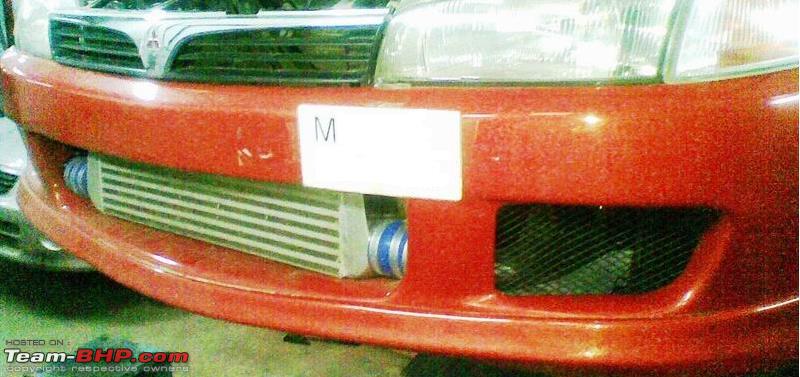

Amey, here are a few pics of a friends car for reference. One shows the top mounts for the intercooler and the other shows the intercooler peeping outta a non EVO bumber. It does look a bit vulnerable though.
If you can get the evo bumper, nothing like it. If you do know someone who is selling just the big front bumper with 6-7inch fog lamp holes on the sides(like Sideways mivec) for a good price, please do let me know. Dont need the skirts, rear bumper or wide body kit.:)
