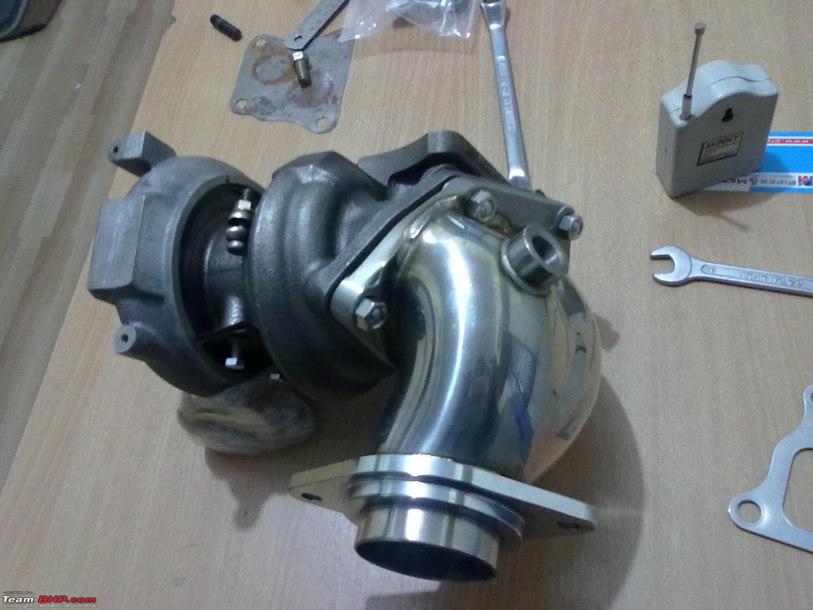

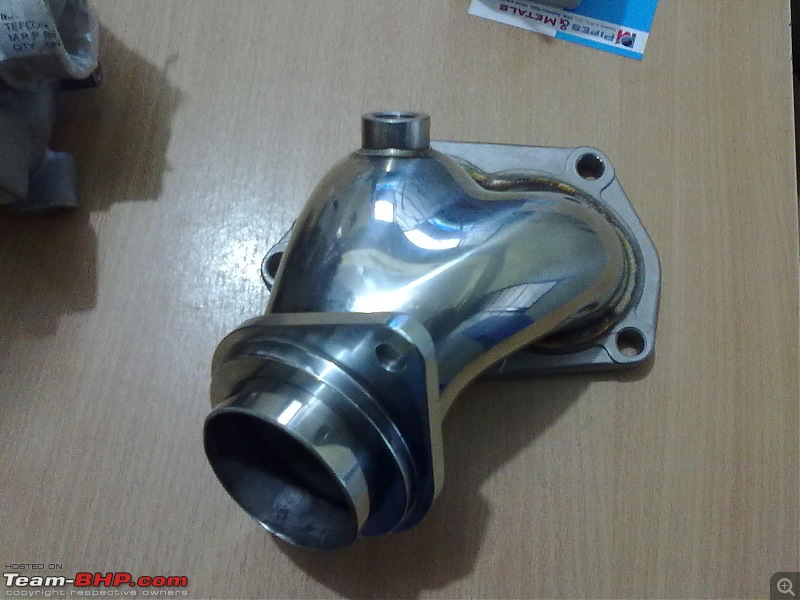

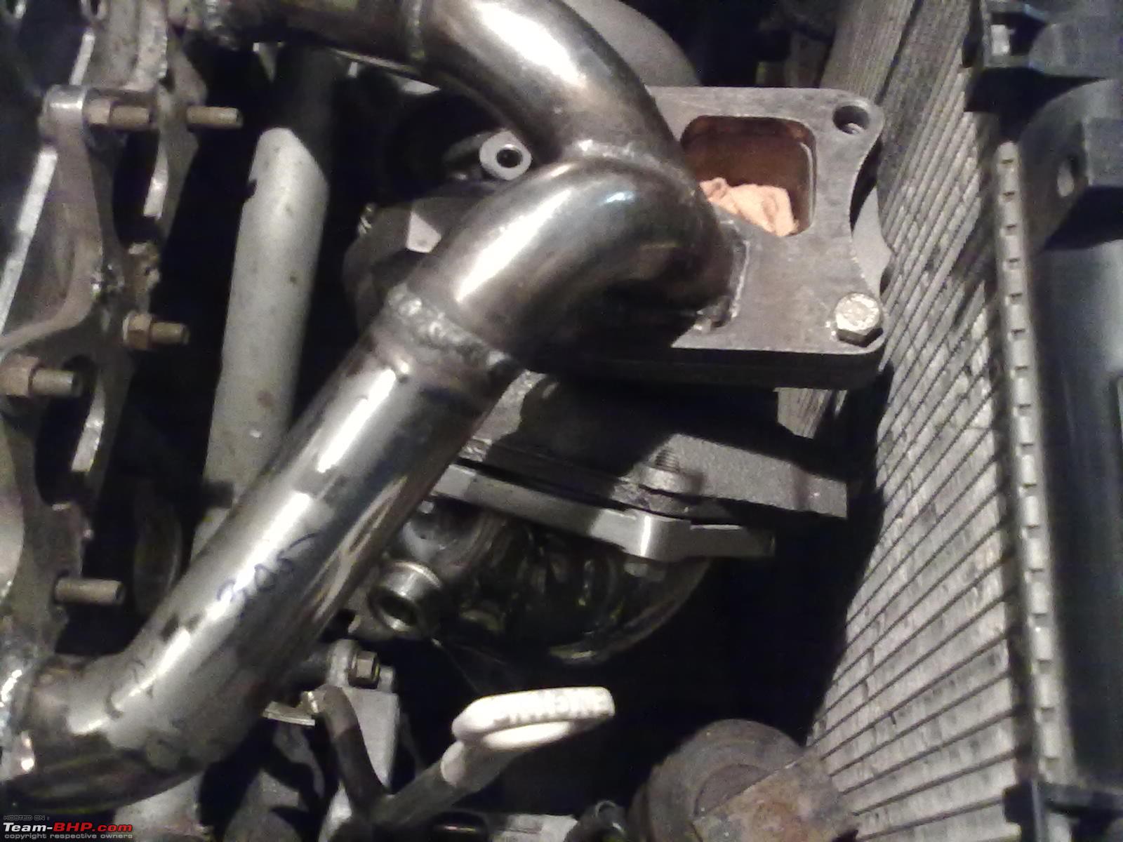

Received the Turbo Dump pipe in mail today, took a trial with it bolted on the turbo and installed in the engine bay along with manifold.
Everything fits perfect!
And yes, it doesnt interfere with the AC Compressor so I get to keep the AC...woooohoooo!
Figured out Intercooler piping also.Suddenly things have started rolling fast.:D
