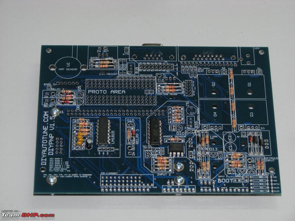

Finally started building or rather assembling my ECU,months after it arrived.Now that my car is running, I can concentrate on these things.
A few pics that I took in the process,
My makeshift workbench lol:
Engine swap/Performance mods in Lancer-img_3780.jpg
Starting off with soldering all the resistors first
Engine swap/Performance mods in Lancer-img_3781.jpg
Resistors,Diodes,Op-Amps,transistors,capacitors, etc. installed/soldered.
Engine swap/Performance mods in Lancer-img_3785.jpg
The Microsquirt module installed on the mainboard.
Engine swap/Performance mods in Lancer-img_3788.jpg
Almost there!
Engine swap/Performance mods in Lancer-img_3789.jpg
Took me 4 hours to do all this.Next in line is wiring up the Mainboard to the adapter board and then its time to flashing the firmware to bring the ECU to life and then loading a base map.
