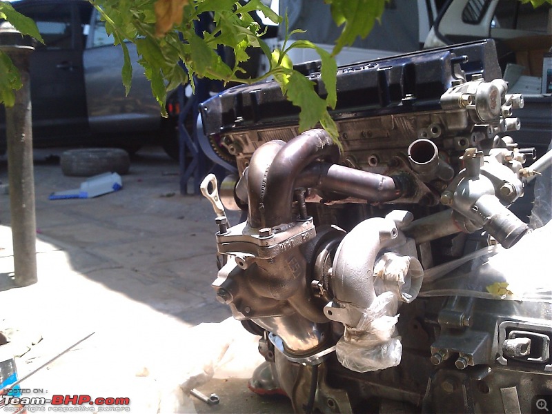

After rebuilding the engine, and changing the head, we had never tried whether the custom made turbo manifold and the turbo fit well with the new head because the manifold was made after taking measurements with turbo installed with the old SOHC head.
So we thought, why not try out before the engine goes inside tomorrow.
It was such a relief to know that everything fit just fine. :D

The dump pipe is readymade but the manifold is made locally. A few modifications would be done to this manifold to make a port for installing the external wastegate.

With the seperate runners, you know you need 2 wastegates. Your plans of merging the 2 set of runners to a single wastegate is going to cause boost-creep. Where the path to the wastegate provides resistance and cannot bleed all the extra air. Hope you have planned for that.
I know that buddy and still in a dilemma what to do about it.:Frustrati

and is your manifold made of MS?
Its Stainless steel mate.
