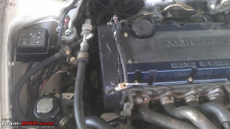

After completing the engine build, the car was ready to roll but got stuck because unfortunately we did not have the upper timing belt cover.The search for the same turned out to be more difficult than we thought.
Frustrated with non availability of the same, we finally decided to make one ourselves. lol:
Here are a few pics of the same,please excuse the poor picture quality,thanks to phone cam and noob photographer :P
Engine swap/Performance mods in Lancer-imag0080.jpg
Engine swap/Performance mods in Lancer-imag0082.jpg
Engine swap/Performance mods in Lancer-imag0086.jpg
Engine swap/Performance mods in Lancer-imag0087.jpg
I know its not a very cool looking cover but then I don't care as long as it serves the purpose.
Now that a cover is in place, the car is finally home after almost 5 months and now the run in period for the new engine begins.

Also,nothing special but I thought that the blue colour I chose for the valve cover was too dark so repainted the valve cover.lol:
This is how it looks ( Note: This is an older pic,the manifold isnt changed in this pic.Sorry but didnt click any snaps today.Might do tomorrow)
Engine swap/Performance mods in Lancer-red-valve-cover.jpg
