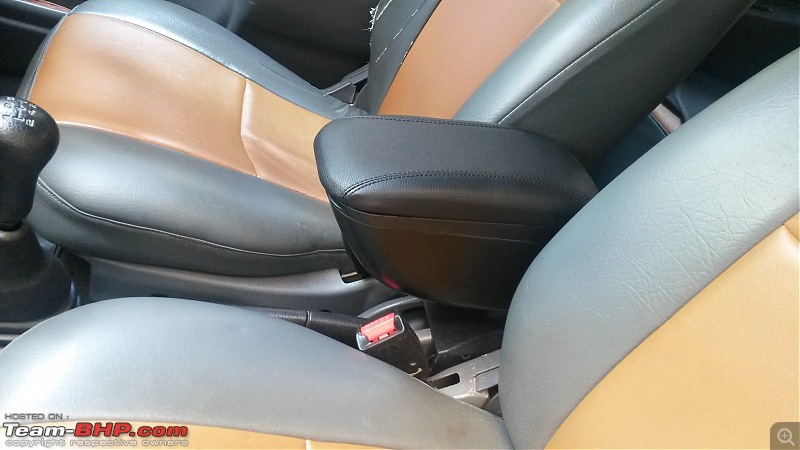

So, a couple of weeks back an office colleague of mine was showing me around his new Scorpio, and I happened to notice that his S4 had armrests on all seats. Upon enquiring, he told me about a fabricator he had found who could fit arm rests on all vehicles. And thus, the arm rest itch came back with a vengeance.
Finally found some time last weekend, and decided to try it on the Liva - the new long drive car in the family (given its good driveability & lower running costs). Had initially planned to install only the driver arm rests, but ended up installing both driver & passenger ones.
It involved removing the seats, stripping them to its base and welding the bracket onto the seat frame itself.
The whole process took around 3-4 hours (mine was the only car being worked upon that day).
Listing down the positives & negatives I could think of over 2-3 days of usage:
  • Almost OEM like fit & finish
  • Solid fitting a.k.a. wont break easily like the universal arm rest
  • Cheap. I was charged 2.5k for the pair. A single one could be had for 1.5k
  • Can be folded up when not in use, and wont interfere with anything
  • All cupholders and accessories below arm rest are completely usable
  • Wearing/removing the seat belt is not as easy as it was. Although I noticed that the amount of effort needed is almost equivalent to what I would need while using my friends Vento.
  • Too far. His shop is located in the outskirts of Delhi (Nangloi), and his factor further out (Kanjhawala). The shop is closed on Sundays and I had to drive to Kanjhawala. Approx 40kms one way from my place in Gurgaon. Took me 1hr 15 mins on a Sunday.
  • I should have got only the driver side installed. In my enthusiasm, got both installed. It could be my mental perception, but it feels a bit cramped (lesser empty space), although it still scores very high on comfort.
  • Need to remove/strip seats - can be an issue for some people who don't like OEM stuff being opened outside ASS
Posting some pictures for you guys.
Very nice work
This is the most ideal and OEM way have an armrest in the car.
Can you share pictures of the welded frame. I have had this idea before, but the thought of stripping and welding a brand new car led me to alternative methods.
Your setup would look much better if the upholstery matched the seat covers.
Unfortunately forgot to click pictures of the welded frame as I had walked out for lunch when they finished welding one of the frames, and by the time I was back they were putting on the foam covers.
Its basically a frame made of three sheets of metal making a square-ish shape with one side open (the side to be welded to the seat). The opposite end of this has a small rod projecting out, on which the armrest swings as well as the bolt to tighten it.
It actually does! Probably not clear in the pictures, but the seat backs are PU of the same color, although the seat PU is a bit darker given it has been in use for some time.
Hope this too will take the same shade once it starts getting used.
