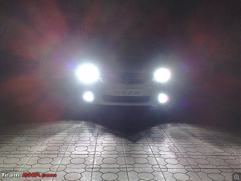

I have installed P4 50W HID's for my headlamps and P4 35W HID's for the fogs as 50W weren't available in H8 size for the fogs (atleast not in P4). Have been running this setup for almost 3 months now and am very happy with it. I think HID's would be a far better option than 100W halogens for the fogs. But i would really like to know more about these 68 LED bulbs though.
Here are a few pics of my SX4 looks from the outside with the 6000k HID's
Attachment 109192
Attachment 109194
Attachment 109193

@prince: Please post a view from inside the car, that makes more sense. From the front everything looks too dazzled for our poor eyes :)
