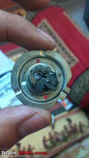

My bulb after 3.5 years of use. It was a 80W Narva bulb. Bulb was still functioning , I replaced them as they had become weak.
Attachment 1134229
How are Narva bulbs compared to other brands like Philips or Osram? Where are they available in Bangalore?
Attachment 1134229
Hi,
Hella 100/90 bulb met a similar end is my car, this was due to loose negative connection between bulb and the ceramic holder. I have replaced this temporarily with the stock bulbs that I always carry in the car (for emergency use).
