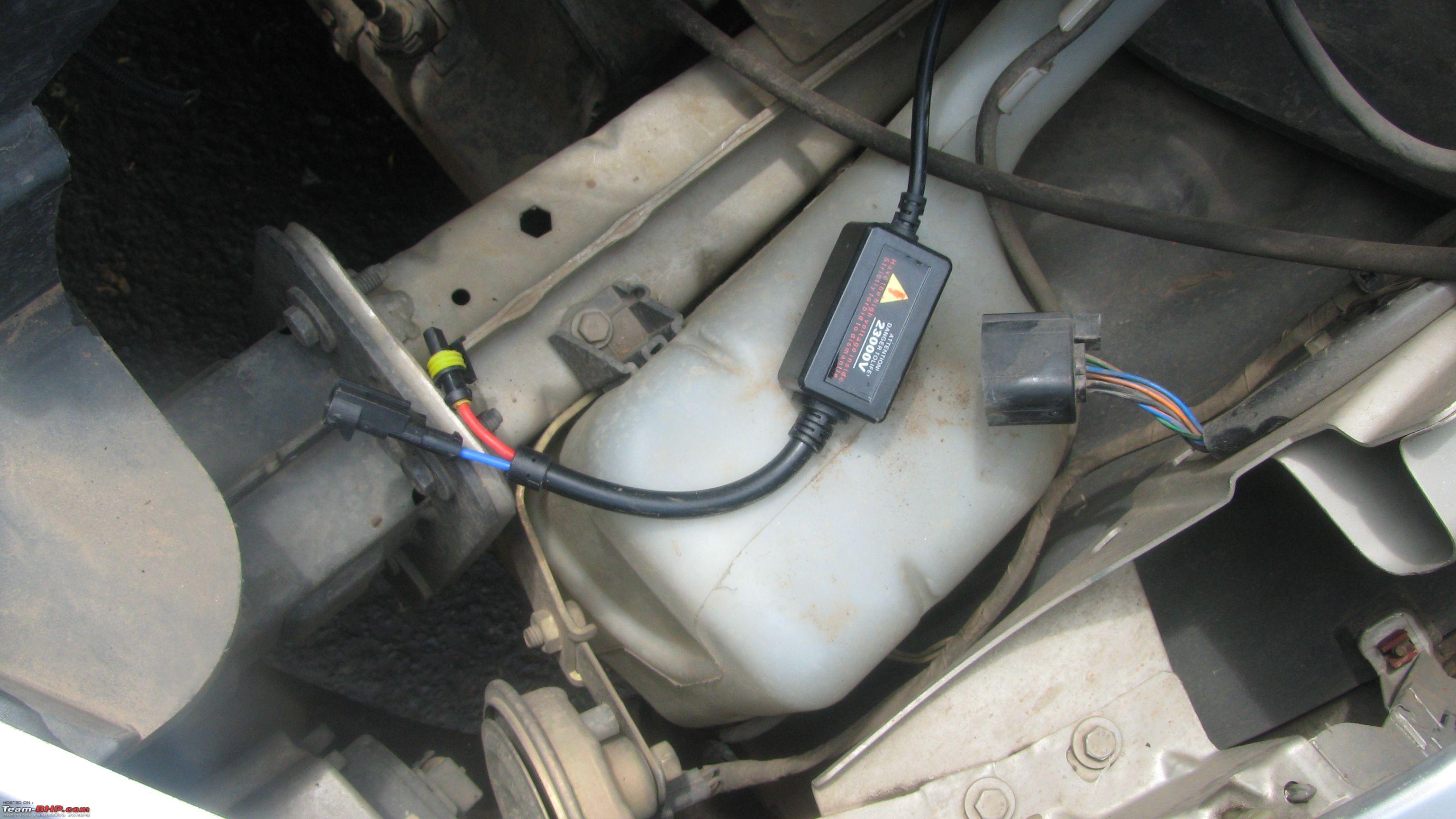

3. Views of Other components as fitted in the engine bay.
Auto Lighting thread : Post all queries about automobile lighting here-ballast1.jpg
Auto Lighting thread : Post all queries about automobile lighting here-ballast2.jpg
Auto Lighting thread : Post all queries about automobile lighting here-controller.jpg
Auto Lighting thread : Post all queries about automobile lighting here-h1-connector.jpg
Auto Lighting thread : Post all queries about automobile lighting here-rear-wiring.jpg

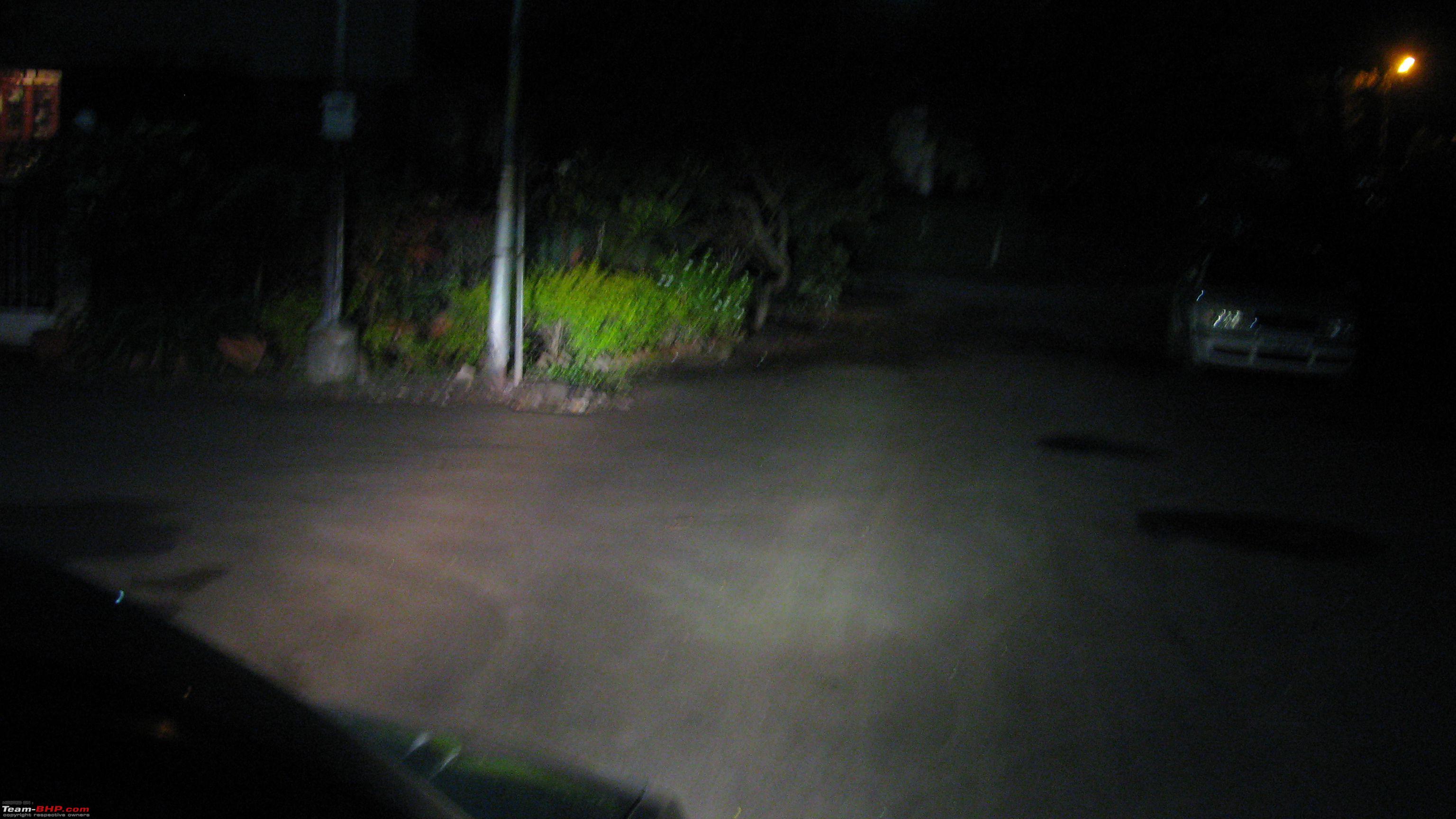

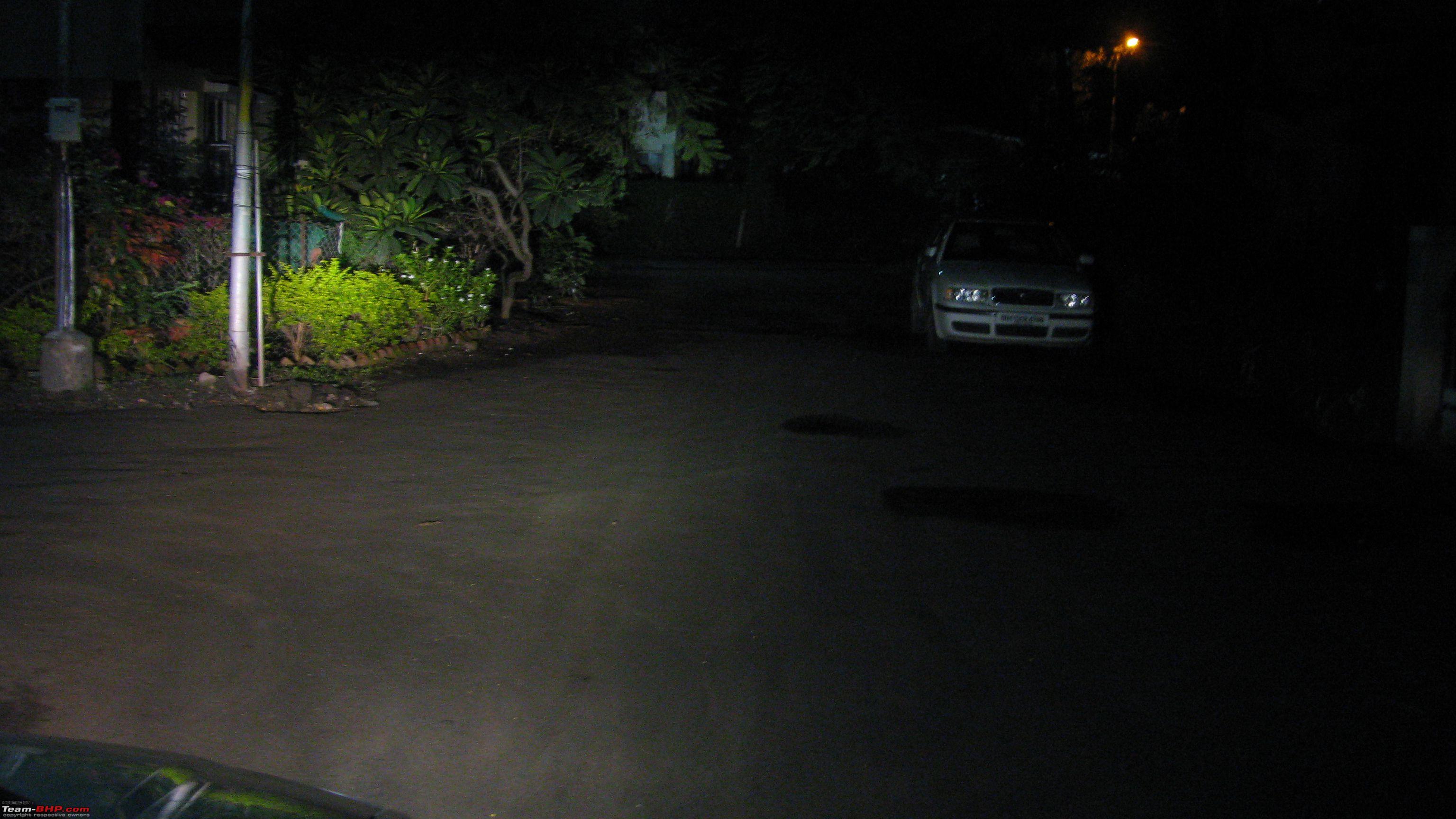

Now for some before & after photos. I have a 2007 vintage digital camera & its low light performance is not good. The Fusion's head lamp, even after the XtremeVision bulbs, was so pathetic that it was not registering properly. So I am posting the Santro's headlights throw instead.
A. Santro high beam
Auto Lighting thread : Post all queries about automobile lighting here-santrohigh.jpg
B. Santro low beam
Auto Lighting thread : Post all queries about automobile lighting here-santrolow.jpg
C. Fusion high beam - max beam adjust
Auto Lighting thread : Post all queries about automobile lighting here-fusion-projector-high-max-beam-adjust.jpg
D. Fusion high beam - min beam adjust
Auto Lighting thread : Post all queries about automobile lighting here-fusion-projector-high-min-beam-adjust.jpg
E. Fusion low beam - max beam adjust
Auto Lighting thread : Post all queries about automobile lighting here-fusion-projector-low-max-beam-adjust.jpg
F. Fusion low beam - min beam adjust
Auto Lighting thread : Post all queries about automobile lighting here-fusion-projector-low-min-beam-adjust.jpg
Went in for white angel eyes only. The photos do not give a complete picture of the improvement. I would say that the light intensity & throw has improved by an order of 4 times. Will suffice for my requirements & budget.There is a 1 year replacement warranty on all parts. The bulbs are H1 type. Joy agreed that D2S would be the best, but availability of D2S bulbs in the Indian market was an issue & so replacements while travelling would be a problem. He is also developing a projector that will come close to Morimoto FX-R. He already has one that matched Mini D2S. The models are available with a range of lens sizes from 2.5" (ultra economy0 to 3.2" (top end).
