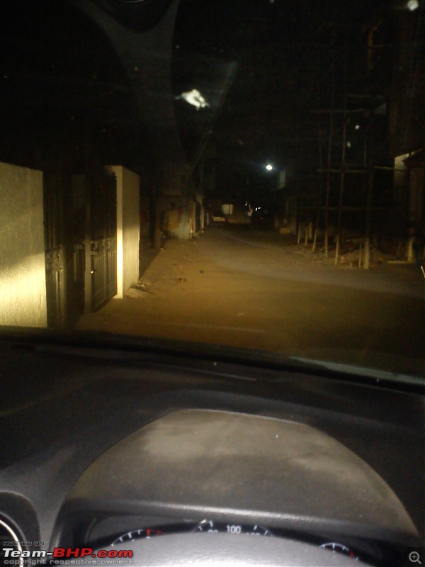

Finally got the Headlamps changed to Osram H4 60/55W. There seems to be some improvement. However, I fail to understand what is causing that dark black spot on right hand corner of attached images. That is a grey area. It seems that installation of RH bulb is slightly inclined ( i.e. the three prongs of bulbs are rotated a bit anticlockwise from drivers POV ). Is that correct ? IMO its done to avoid glare for on coming traffic, but the RHS headlight is pretty useless. Next to meaningless. Very poor focussing.
I could not replace the bulb on my own in the dark, so had to drive without RHS bulb ( to the shop where I had purchased the bulb ) and realized that most of lighting in provided by LHS only.
Halonix OEM High Beam :
Auto Lighting thread : Post all queries about automobile lighting here-halonix-oem-high-beam.jpg
Osram High Beam :
Auto Lighting thread : Post all queries about automobile lighting here-osram-high-beam.jpg
Halonix OEM Low Beam :
Auto Lighting thread : Post all queries about automobile lighting here-halonix-oem-low-beam.jpg
Osram Low Beam :
Auto Lighting thread : Post all queries about automobile lighting here-osram-low-beam.jpg

The problem exists with both the bulbs, be it OE Halonix or new Osram. Its the installation which is the problem here. I am attaching a rough image to indicate what is, I believe, the problem. When I was driving the car yesterday night without right bulb (to the shop for installation of bulb ), most of lighting was done by left light. What a waste of right bulb!!! This could be done to prevent direct light from hitting oncoming traffic. Concept might be good, but implementation is pathetic. Let me try focusing, but I just cannot understand where the right beam is going. Looks like Projector is the way to go. Rs. 9500/- quoted by India Blaze or something, but will have to confirm how to get the thing installed in Vadodara.
Now I value how good Baleno lights were! With bulbs from Innova, even night driving was possible for an individual like me.

It seems my problem is partially solved. Yesterday when I had parked the car in office, while walking towards the main office for card punching, I realized that "Yellow Sticker" might be hampering performance.
So at night, I removed the sticker and applied it a position where it would hamper significantly less. Success! The light performance improved by 50%!
The fact that I had adjusted the light beam a bit high as compared to left beam also became apparent. This was done in my earlier quest to improve lighting.
At last some relief. The Yellow sticker almost forced me to get projectors ( which BTW I am still considering ).
