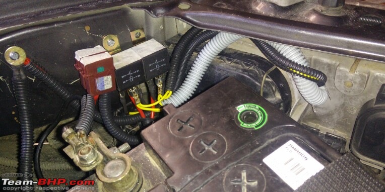

Originally Posted by SunnyBoi (Post 3769969)
The wiring kits available for H1 H7 are terrible in the market. I had a roots H1 H7 wiring kit in my old car which kept on giving me problems including finnicky wires, melted fuses and burnt ceramic holders. Apart from roots, only local brand ones are available.
So this time I made my own :D
An update about the DIY headlight Relay. Its working beautifully! I've driven through slush and heavy rains and not once has the lights flickered or fuse blown.
I'm using Hella H7 100W for low beam and Philips H1 100W for high beam.
Below photo shows you how its fixed on the car. Drilled a hole on the headlight assy, passed the wires then sealed the hole using hot glue. No moisture can enter the headlights now and no problems of finnicky wires passed through bulb covers.
Auto Lighting thread : Post all queries about automobile lighting here-img_20150804_12314801.jpg
All leads heatshrinked
Auto Lighting thread : Post all queries about automobile lighting here-img_20150809_08352601.jpg
Low Beam
Auto Lighting thread : Post all queries about automobile lighting here-img_20150818_21402701.jpg
High beam
Auto Lighting thread : Post all queries about automobile lighting here-img_20150818_21403401.jpg
Night pictures from camera do no justice to the awesomeness of these lights :D not to mention the satisfaction of having done a successful DIY!
