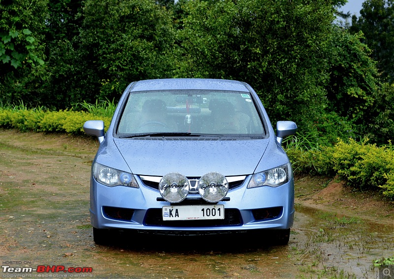

I removed FX-R projectors (before to it had used Morimoto Projectors) & hid kit to upgrade to Lightforce 240 Blitz.
I use these LF only on long highway drives & remove (just 2+2) bolts when not in use
My civic is totally with Halogen lights now
This is how my car looks
Auto Lighting thread : Post all queries about automobile lighting here-dsc_2622.jpg
Attachment 1309476
Philips are 35W; P8 is 55W, that's why was leaning towards P8.
Will fit the HID's on lowbeams as suggested.
Civic looks gorgeous.....those rally lights are amazing
Attachment 1309476
Hi,
Don't you feel these are a tad too big?
Or maybe its the perspective making them look so?
Were you unhappy with projectors? How do the lightforce compare to FX-R's ?

Indeed they are huge (around 9" ), could have brought LF 170 Striker(they are small), but wanted more light on the road so brought LF 240 Blitz.
I do remove them when not in use, so car is back to stock in 5 mins (hardly 4 nut&bolts)
LF & FX-r's are different entities.
As a projector, FX-r are way too good , low beam spread is wide & good & higbeam is OK too.
I had moisture issue in one(left HL) of the headlights, twice I changed FX-r's due to this (burnt reflectors), It's a pain to retrofit & align the Projectors twice(FX-r are not direct fit projectors, one needs to modify the reflectors). So changed the complete headlight assembly(both left & right) to stock Civic headlights
LF, it's like a complete HighBeam with more than half km light range.
The pencil beam from LF 240 Blitz is fantastic.
Talking purely in terms of foreground light (around 20 mtrs from headlight) LF beam spread is not as wide FX-r, though there is an option in LF to adjust the beam pattern from Pencil to spread.
