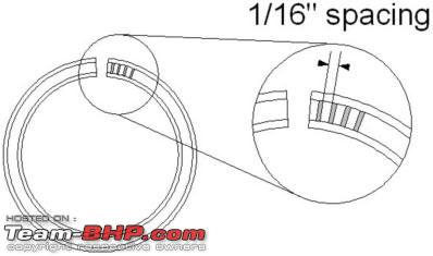

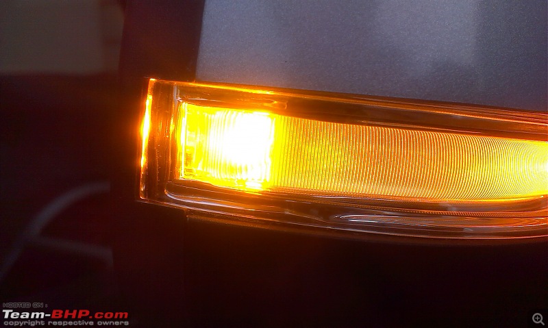

Random question, and I don't know whether it's been answered already (couldn't find it). Cars like BMWs and VWs have these interesting 'light bar' tail lamps, which look to me like LEDs with some sort of diffuser lens. These aren't the better-known multi-LED strands you see (in, say the Alfa Giulietta). Could anyone tell me what these lights are called and how they work? Just curious.
Originally Posted by ajaypjayaraj View Post
The same tech that works for halo rings works for these tail lamps too. If you take a solid glass or acrylic rod/bar and pass light from either ends, you have light passing through it but the light wont be visible like the ones you see in tail lamps. To make this light visible through out the rod/bar in a uniform way, make fine groves behind the bar and you get the effect of the whole rod lit up. The groves cause light scattering and that's how it works. Make it a ring and you have halo rings, make the rod in various shapes and sizes and you have those stunning tail lamps and parking lights, ambient lighting inside cabin, etc. in various colors depending on the LEDs you choose to light it up. See the pics below to have an idea of how simple it is.
Attachment 1307748
Attachment 1307749
Pics source: Google images.
For further illustration of ajaypjayaraj's point, I just clicked some pics of my i20's ORVM indicators. In these pics, you can clearly see those groves which spread light and in the next images (the ones in which the indicator has lit up)
you can see the source of the light ; the LED. On looking closely, you may notice that the ends of the indicator are relatively brighter than the other areas(the middle ones) as ajaypjayaraj mentioned earlier. So its just the end point which have the source LEDs and its those small groves which spread the light and ultimately end up in making the light appear so beautiful as a whole.
Hope that helps.

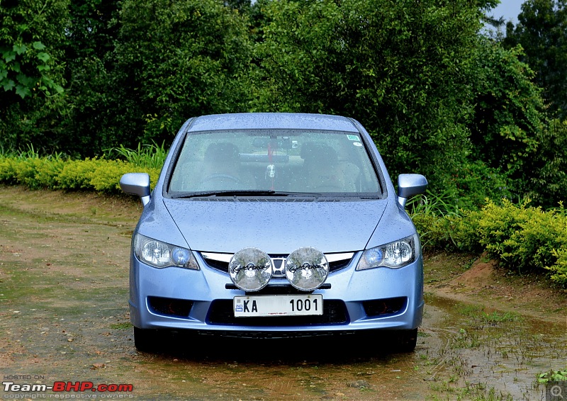

I removed FX-R projectors (before to it had used Morimoto Projectors) & hid kit to upgrade to Lightforce 240 Blitz.
I use these LF only on long highway drives & remove (just 2+2) bolts when not in use
My civic is totally with Halogen lights now
This is how my car looks
Auto Lighting thread : Post all queries about automobile lighting here-dsc_2622.jpg
Attachment 1309476
Hi,
Don't you feel these are a tad too big?
Or maybe its the perspective making them look so?
mayankk is offline

Don't go for 55W on reflectors, heat emitted from the 55W bulbs will be too much for the reflectors to handle (Though hid's run cooler than Halogens).
Stick to 35W hid's they will suffice the need.
Hi,
Indeed they are huge (around 9" ), could have brought LF 170 Striker(they are small), but wanted more light on the road so brought LF 240 Blitz.
I do remove them when not in use, so car is back to stock in 5 mins (hardly 4 nut&bolts)
