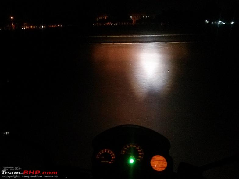

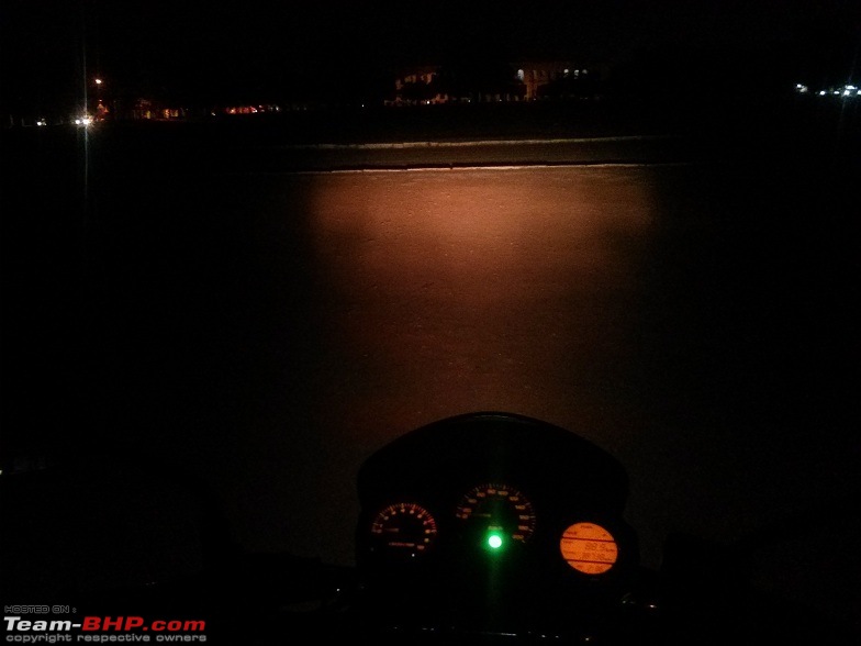

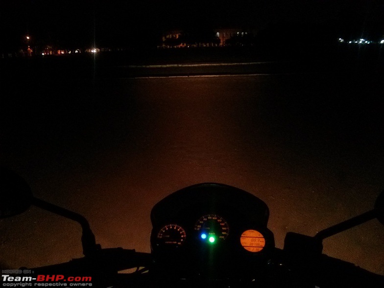

Did some testing on the LED on a field this evening.
I have Philips Xtremevision 60/55 bulb on Full DC system, which means headlight in the pics are at 100%.
All off
Auto Lighting thread : Post all queries about automobile lighting here-1.jpg
LED only
Auto Lighting thread : Post all queries about automobile lighting here-2.jpg
Low beam
Auto Lighting thread : Post all queries about automobile lighting here-3.jpg
Low beam + LED
Auto Lighting thread : Post all queries about automobile lighting here-4.jpg
High beam
Auto Lighting thread : Post all queries about automobile lighting here-5.jpg
High beam + LED
Auto Lighting thread : Post all queries about automobile lighting here-6.jpg
It is not so apparent but the halogen is totally outclassed by the LED
As of this moment I have ordered a second one to be mounted on the left side
SunnyBoi is offline   (3) Thanks
