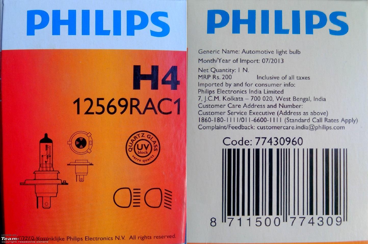

Originally Posted by procrj View Post
what do you mean by imported bulb?Can you clarify? I picked up mine locally but made sure that it was an unopened original philips bulb.
NooB question. How do you check this?
1. Phillips has made in germany as well as other origin bulbs. I have the made in germany bulbs. They claim to have a UV block glass which will protect the lens. Guess thats working for me.
2. If you can see the bulbs directly, the reflector has no shield. In some cars, there is a metal shield which will absorb majority of the heat. It is situated just in front of the bulb. In fact the lens of the lamp gets warm but not hot. In my wagonr, there is no shield and the bulb can be seen directly.
Here is what I found on the box. Guess this is what you are talking about
Auto Lighting thread : Post all queries about automobile lighting here-p1.jpg
Auto Lighting thread : Post all queries about automobile lighting here-p2.jpg
Attachment 1187070
Attachment 1187071
Yes thats the shield. Regarding the bulb I dont remember but the ones I installed had a clearly marked 'Made in germany' imprint on the bulb whereas the shopkeeper showed a cheaper variant which had the same imprint but the text was very blurred and the bulb itself looked bad.
