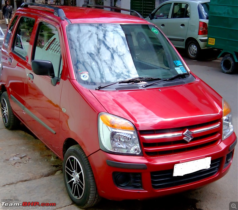

BTW can you kindly post 1 or 2 recent pics of your WagonR's headlamps and since when are you using these 100/90w bulbs in your car?
I have been using the 90/100 for the last 1 month or so. Attaching latest pics of car headlights

I have been using 100/90 from three years. The headlamp assembly still looks as sparkling as new 'after' a wash only
Note that the yellowing is caused due to UV light and the crackling is caused due to heat. If you use an imported bulb of phillips or osram you will not face yellowing issue. If your headlamp assembly has a heat shield inside, you wont have the cracking issue too. Mine satisfues both requirements and hence no problem till date.
