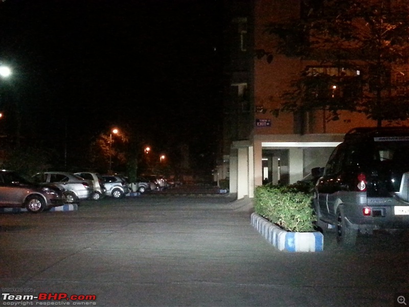

Dear All,
My father gave the car for its 50k km service a couple of weeks back.
I have been using Philips Essential Vision 90/100 for over two years now. These are good bulbs which are not completely yellow but have a tinge of white in them and have decent spread and intensity. The bulbs had conked off once and for some reason the high-beam fuse had gone off a couple of times.
Before giving the car for service, the high-beam fuse had conked off again so my father told the SA to replace it. However the SA suggested to get 6000 K HID's installed instead as they are "way better" than regular bulbs and that he would do the needful.
All this while I was in Ahmedabad and hence didn't know about the events taking place back home. When I came home a couple of days back, I was pleasantly surprised . However the pleasant part of it was short-lived.
What i noticed was that the right bulb is less white than the left bulb. It is not something that would maybe make it fall in different kelvin temperatures, however it is enough to be noticed.
Secondly what i noticed was that these bulbs are from a manufacturer that I have never heard of. (Picture attached)
Thirdly, although the low beam falls perfectly, the highbeam is literally like a beam and goes straight on (not going upwards towards the sky but parallel to the road)
Sorry for the low quality pics :-
Low Beam :-
Auto Lighting thread : Post all queries about automobile lighting here-low-beam.jpg
High Beam :-
Auto Lighting thread : Post all queries about automobile lighting here-high-beam.jpg
The HID kit :-
Auto Lighting thread : Post all queries about automobile lighting here-kit.jpg
Need Help !!
P.S. The Kit costed around Rs 4500. This further makes me suspicious about its quality.

Originally Posted by Enigmatic View Post
Need Help !!
The words "with technical support from Germany" indicates it's a spurious brand - not necessarily bad news, but please don't expect any warranty or support or any guarantee of performance.
Having said that the beam patterns do look good.
