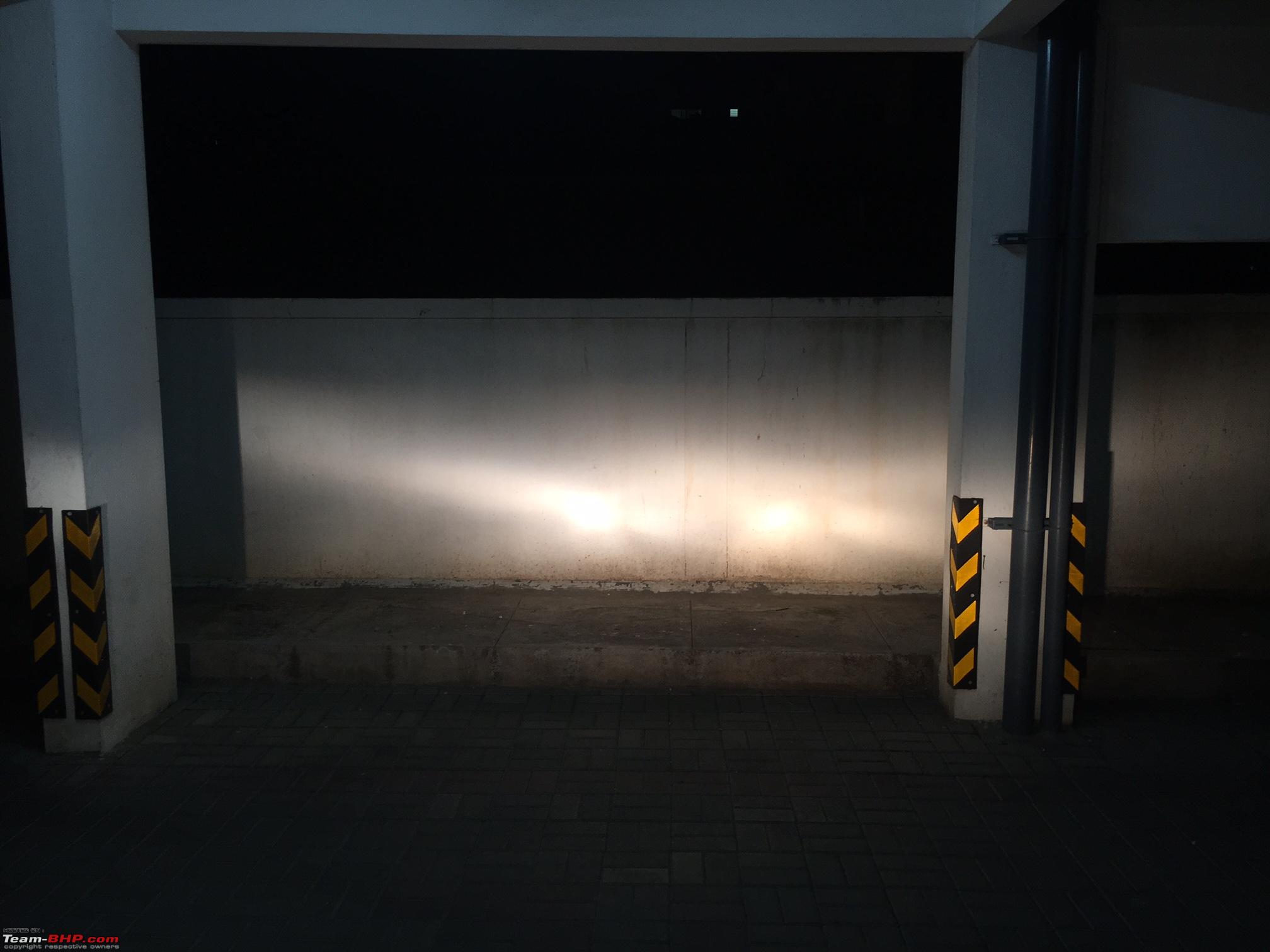

Got down and installed on my Celerio which earlier had Osram Bilux 60/55 from factory. Here are raw comparison pictures with the XV+ on the left side and Osram on the right
Low beam:
Auto Lighting thread : Post all queries about automobile lighting here-img_1394.jpg
The LHS wing is more intense on the XV+ and we get whiter light, which I always prefer philips for. Helps a lot on the highway with the rally too having a similar characteristic. The hotspot is more intense which will mean better spread on the open road.
High beam:
Auto Lighting thread : Post all queries about automobile lighting here-img_1398.jpg
Exposure was reduced for this image to make the hotspot comparison clearer between the bulbs. Here we can see that the bulb is whiter, and has a bigger hotspot which will ensure more spread and little more reach compared to the stock bulb.
Though it does look good here, I dont take their 130% numbers seriously. The intensity might be somewhat close to the Osram 100/90 on my SX4, but get a genuine Phillips rally 100/90 and the rest will be shadowed easily.\
Like I mentioned before, this bulb is a worthy upgrade at this price, and given that my Celerio doesnt see much of night driving, forget highway in comparison to my SX4. Recently I found out that the Osram 100/90 on my SX4 were useless compared to the Rallys I had earlier.

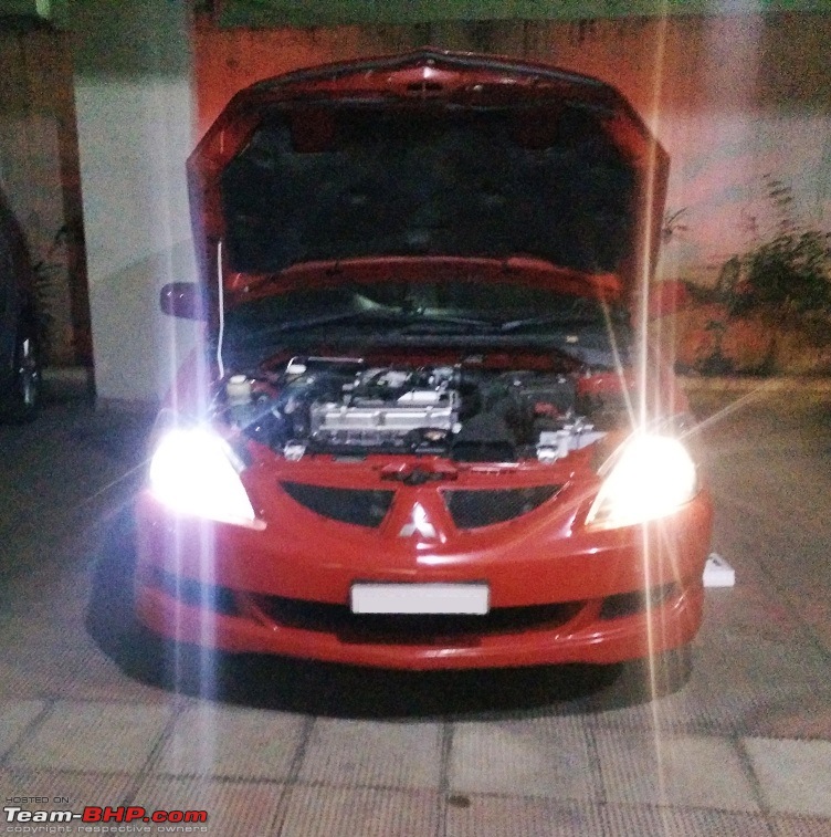

Difference between LED in left and Xtremevision +130 on the right

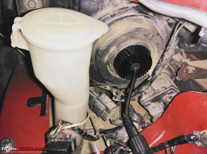

These LED bulbs are fanless and they go perfectly into the dust cap on my headlight; sealing even better than the stock H4 bulbs did!

Although while installing I realised my passenger side reflector was drooping down, the screw holding it up as per headlamp adjuster level has fallen off. I need to open up the headlamps to fix it, I might as well put in projectors in them.
