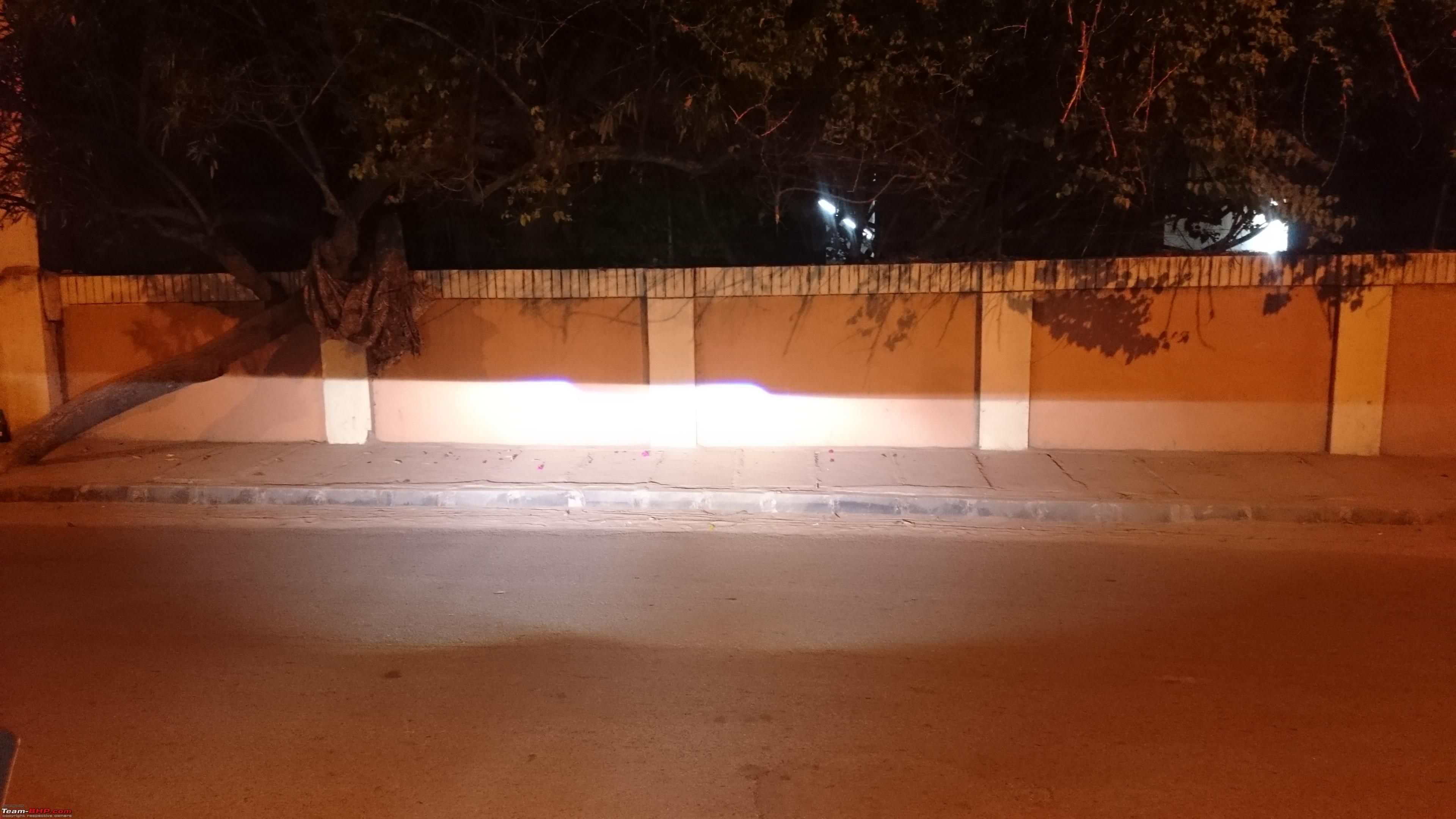

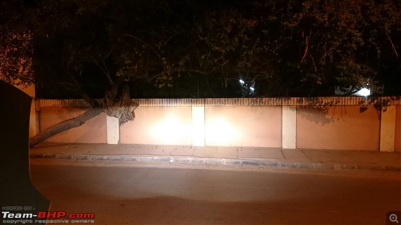

Mini Super V2 Projector Setup ( Xenon Planet) on my Baleno :
Hot Spot is well centred resulting in superb high beam coverage. I have uploaded a video showing the beam pattern of Mini Super Projector.

Dr.Naren is offline   (2) Thanks

Old 7th January 2017, 11:16   #10260
graaja's Avatar
Join Date: Nov 2013
Location: Coimbatore
Posts: 3,715
Thanked: 25,727 Times
This is really good Dr. Naren. The cutoff of the projectors look very clean. The high beam hot spot also looks very good. Compared to this, the cutoff and high beam throw of the projectors that I got installed from Lumens' Systems is very bad. Maybe XenonPlanet is doing a better quality control on the components that they use.
How is the quality of the retrofit and wiring done by XenonPlanet? Do they do a clean wiring with proper heatshrink tube insulation and copper tape, and good sealing of the headlights?
Off topic, I have summarized the quality and reliability issues with my projector setup in this post in a different thread.
