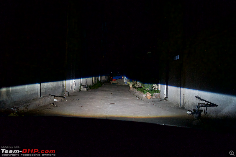

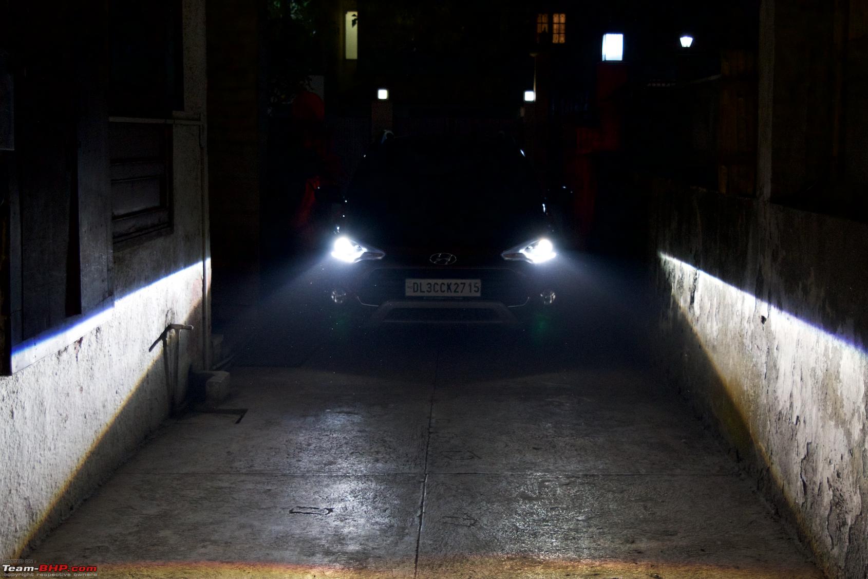

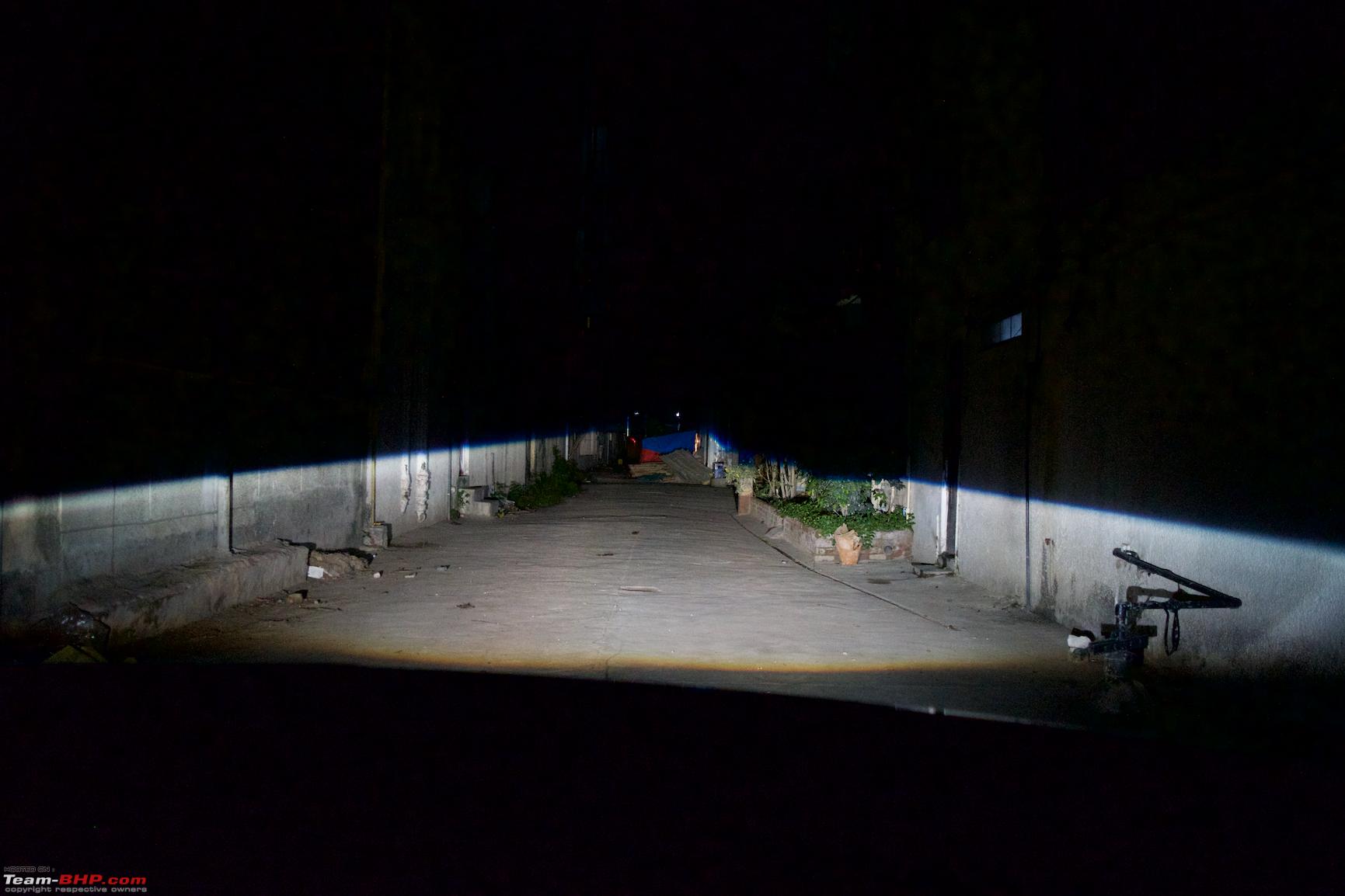

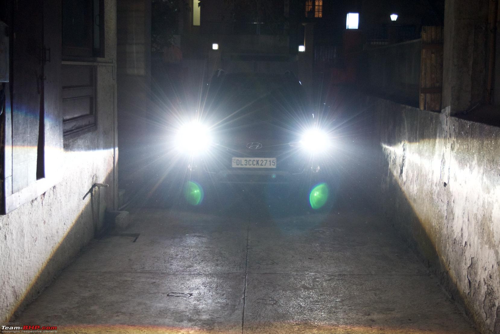

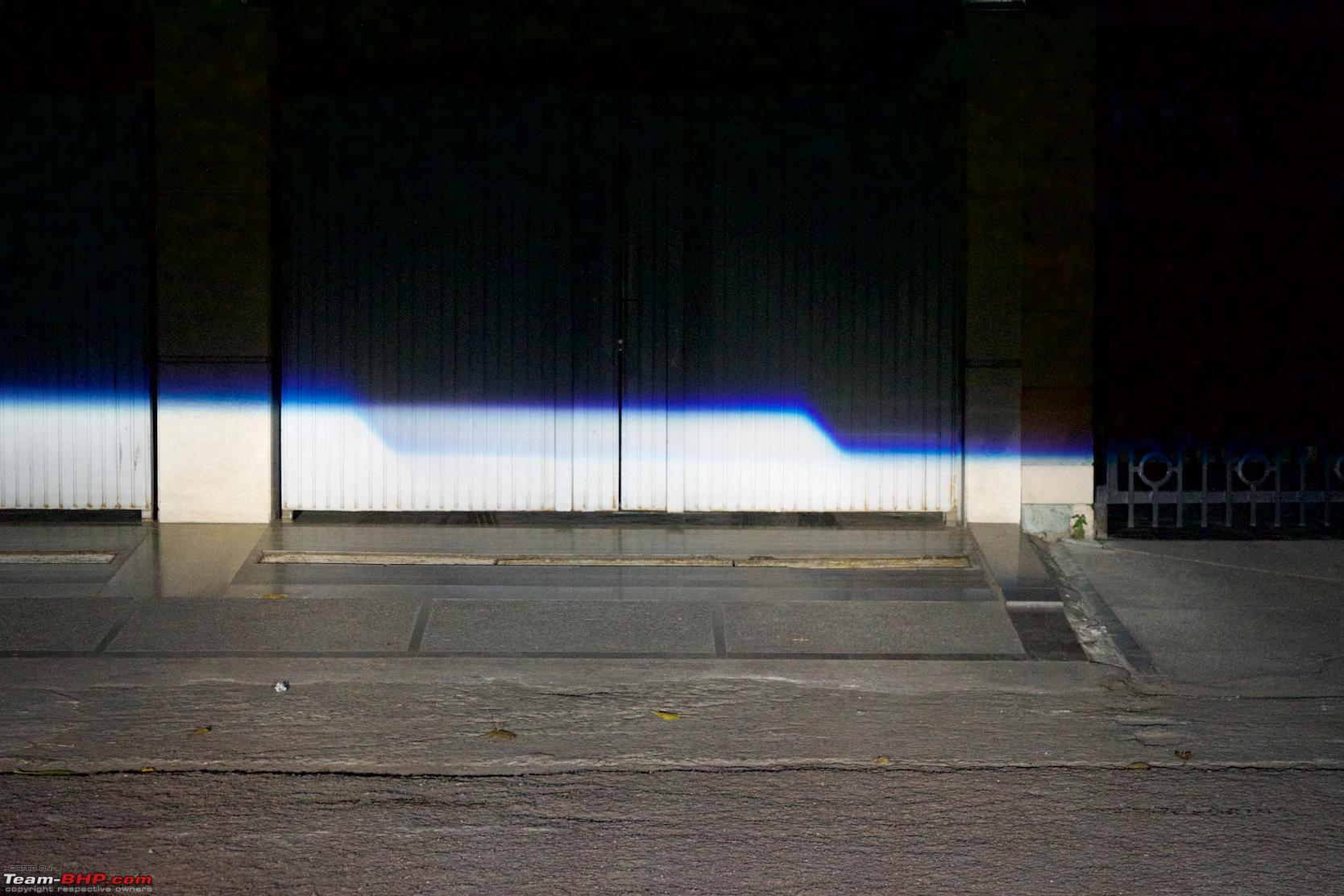

Projector upgrade - Morimoto Mini H1 6.0 to Morimoto Mini H1 7.0
Ballasts - XB55, bulbs - 4500K.
Low-beam cut-off
Auto Lighting thread : Post all queries about automobile lighting here-h17.0-106.png

Closer shot of the cut-off
Auto Lighting thread : Post all queries about automobile lighting here-h17.0-104.png
Low-beam front shot (no glare)
Auto Lighting thread : Post all queries about automobile lighting here-h17.0-102.png
High-beam front shot (lots of glare)
Auto Lighting thread : Post all queries about automobile lighting here-h17.0-103.png
Low-beam output in an unlit back-lane
Auto Lighting thread : Post all queries about automobile lighting here-h17.0-108.png
High-beam output in an unlit back-lane
Auto Lighting thread : Post all queries about automobile lighting here-h17.0-107.png

@harsh79: Brilliant output!! Also that blue cut off colour is really beautiful. The alignment is also perfect.
Good to see that you have upgraded from Mini H1 6.0 to Mini H1 7.0. 7.0 is fully compatible with 55W ballasts unlike 6.0. Could you please share the cost?

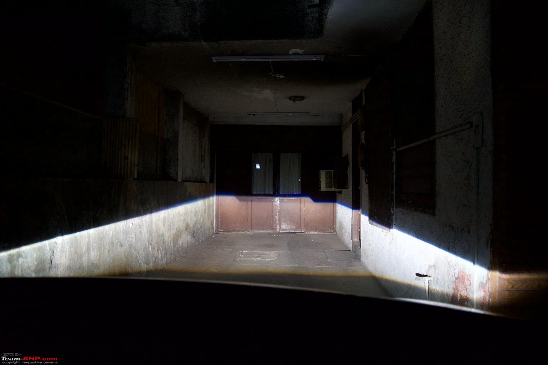

Complete spread from the new 7.0's
Auto Lighting thread : Post all queries about automobile lighting here-h17.0-104-1.png
