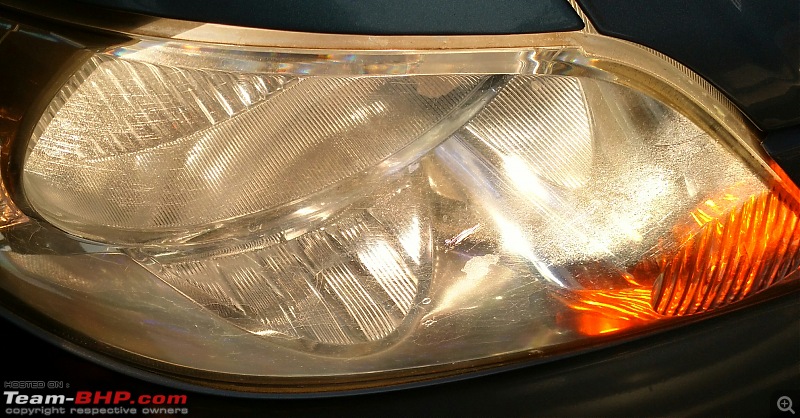

I have a 2006 Honda City ZX VTEC. Lately the headlight throw has been awful and saw that the headlight cover was in a pretty bad state! Attaching pictures of the same.
Can this be fixed with the 3M headlight care stuff or any similar products, or should I get the assembly changed? Honda are quoting 16,000 without labour and taxes.
Are you using higher wattage bulbs? I had the same issue on my Swift (inside plastic peeled off). 3M offers headlight restoration package.
This can be tried as a DIY. There are many videos on YouTube and I have seen worse headlights been restored. To start off, you can try the toothpaste method. Suggest you to check the videos on YouTube.
Try the plain Colgate method to clean up the lenses first. That will remove the 70-80% yellow build up on the outside of lenses.
3M headlight care stuff will make a good difference. We had got the headlight restoration treatment done on a BMW 530D which had tired looking headlights and it was back up to 90% of its original glory.
The OE polycarbonate headlight lenses have a hardcoat on it which resists UV rays and chipping. Once headlight restoration is done, i.e., lenses are buffed out the hard coat is removed. So after restoration the lenses will deteriorate faster than if it were new. So abroad some of the professional headlight restorers use a chemical product which hardcoats the plastic lens after buffing is done. In the absence of hardcoat treatment i suggest you get a layer of 3M body protection film applied on the headlight, it will give some protection.
Edit: If the damage is internal it could be fixed but will have to separate the lens.
Sankar is right. In your own pictures you can see sort of a film peeling off, whenever it has peeled, there are major scratches. It's the hardcoat that has failed on your headlights. However applying body protection film wont help as the glue will come off easily owing to high temperatures from halogen bulbs.
It can be fixed, however it is very difficult to say how much of an improvement you can expect after a restoration. Toothpaste will not make a dent to the fading you have.
I recently cleaned a friend's 13 year old santro's headlights and they came out well.
