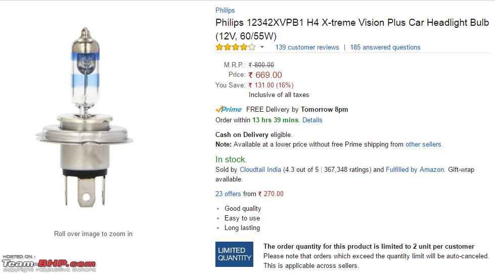

I think they are comparable - two different stables Osram and Philips. Just try and check they are non-Chinese, if you have an option. I personally trust Osram a bit more. My own Brio is running on NB+ since 2012/13 (it is an October purchase).
I already placed an order for x-treme vision, reading reviews on AMAZON; ordered a pair with same-day delivery, would install back the 90/100 during highway drives as it is just a 10 minutes job to fit the headlights.

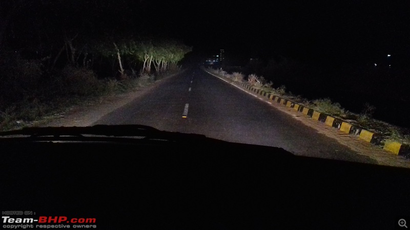

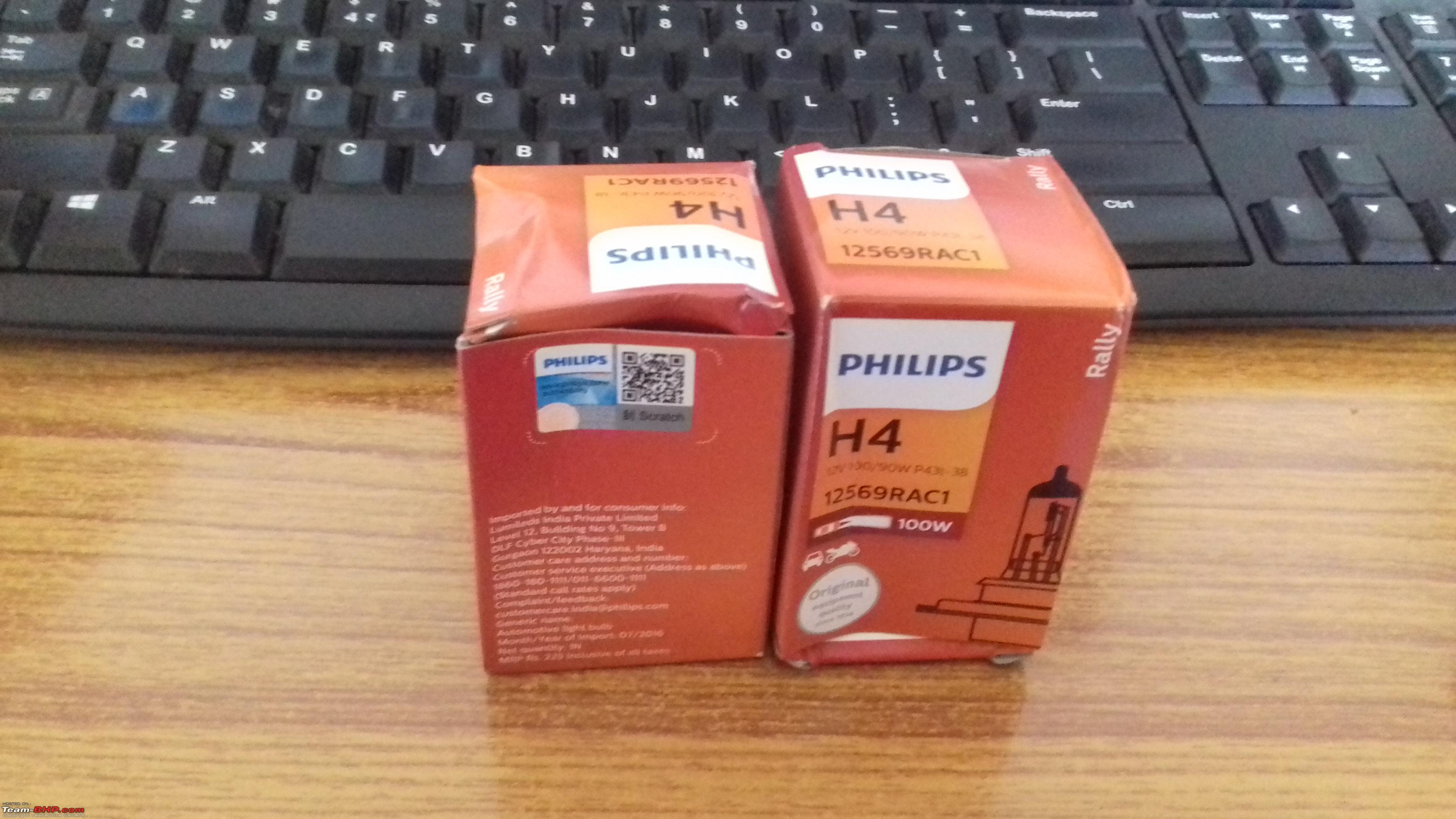

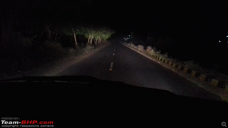

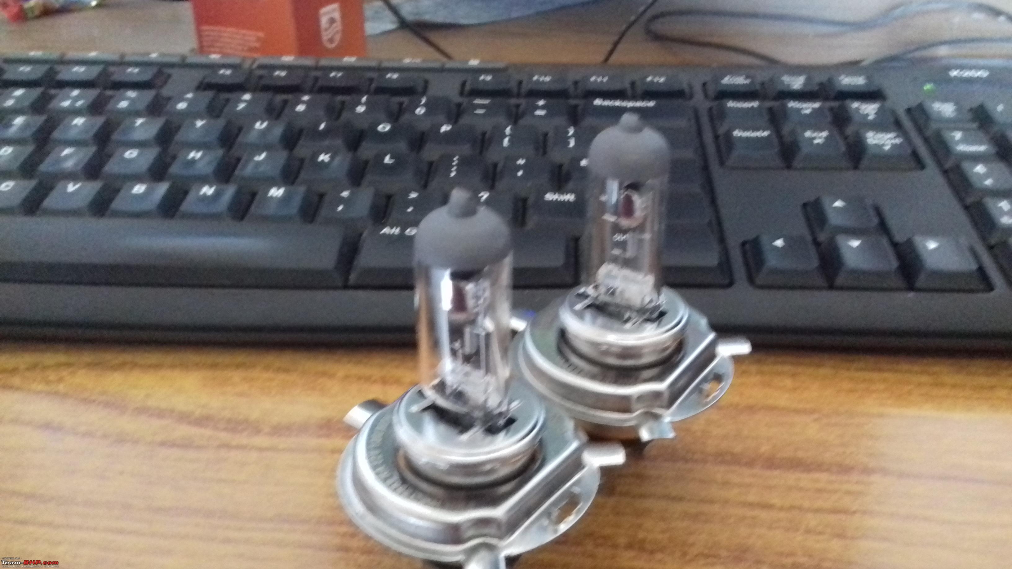

Finally installed Philips Rally 90/100W which I recently got from Amazon.
Great light I must say. 30`35% improvement over Hella and around 10% over Osram Rally 90/100W.
Had to do some Horizontal alignment, but its awesome now. I think I got 90%+ type of set up I desired for. Shall stick with it for long time now. Fortunately, hunt for better light set up is over. Low beam is strong enough for moderate speed cruising.
My mobile camera doesn't do much justice to sheer amount of light these bulbs throw.
Attaching a few images.
Low Beam
Auto Lighting thread : Post all queries about automobile lighting here-20170110_220845.jpg
High beam, fog lamps Off
Auto Lighting thread : Post all queries about automobile lighting here-high-beam-without-fog.jpg
High Beam, Fog Lights On

Random
