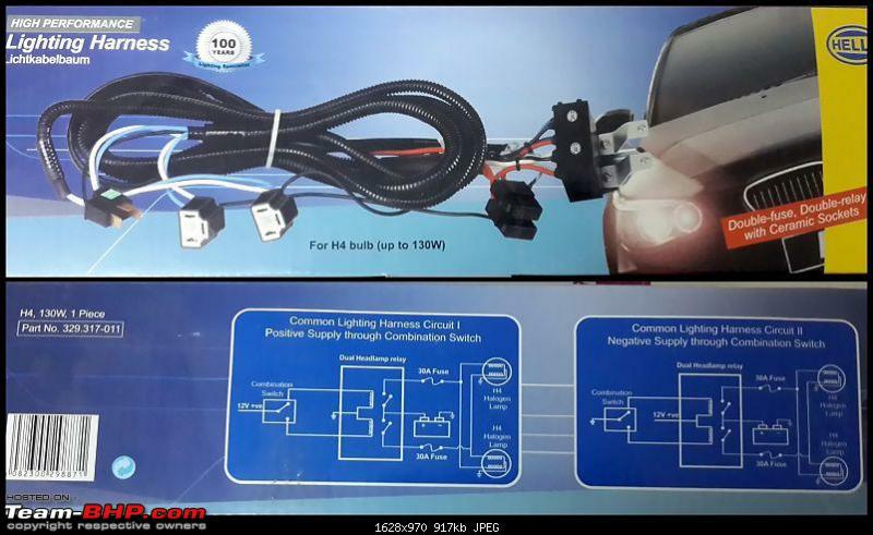

Old 9th December 2016, 20:15   #10199
Join Date: Oct 2011
Posts: 12,345
Thanked: 21,452 Times
Originally Posted by HighwayHopper View Post
I dont see much reviews on Philips H4 12v 100/90 P43t Rally. Are these the bulbs you are using ? If this is good, then i will go with the below combination.
Here's are the bulbs and wiring harness that I am using in my Swift.
Using this bulb currently
Old packaging of the same bulb that I am using
Wiring harness that needs to be used with the bulbs
Thank you a4anurag. I met a local accessory guy who was talking about Lumex relay kit and was insisting me to go with this by saying that it was much better than Philips. He also said that he will only install the kit and if there were any alignment issues then that needs to be sorted out by an electrician. I will visit Ministers road this weekend and see if I find this original Philips combination from any of them.
