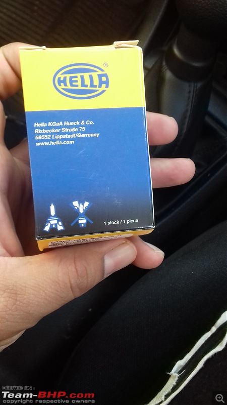

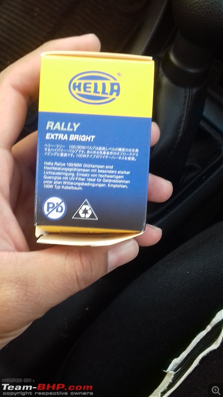

In my Swift VXi, I am running Lumax Wiring kit along with Osram Rally 90/100W bulbs.
The issue I am facing with this set up is poor high beam focus. Somehow, I am not able to get it correct. So thought of having "Hella" Rally 90/100W from Jalaram Car Accessories, cost Rs. 600/- for two bulbs.
All I can say is this : Dont go for Hella Rally bulbs. No, absolutely no gain in intensity. Focus of high beam is better, but intensity is less. Barely as good as Osram Bilux 55/60W.
Another thing I have observed is post headlight replacement in June 2016 (thanks to a minor accident), RHS beam focus is inconsistent. Irrespective of how much I align horizontally but the beam focus is just not getting right. So, bulb might not be culprit in Osram Rally 90/100W setup.
From my experience what I have observed is :
1) Best Intensity in 90/100W : Philips Rally
2) Best Low beam in 55/60W : Philips Xteme Vision+
3) Best High beam in 55/60W : Ring Ultima +120 Xenon
4) Optimized set up in 90/100W : Osram Rally
Surprisngly, Philips Rally 90/100W are not available on Amazon or Flipkart. 100/130 is way too much, but getting 900/100W (preferably manufactured in EU, but not in India) is tough.
To conclude this post, I wasted my 600 rs. on Hella Rally 90/100W bulbs, hope others can avoid the same.
