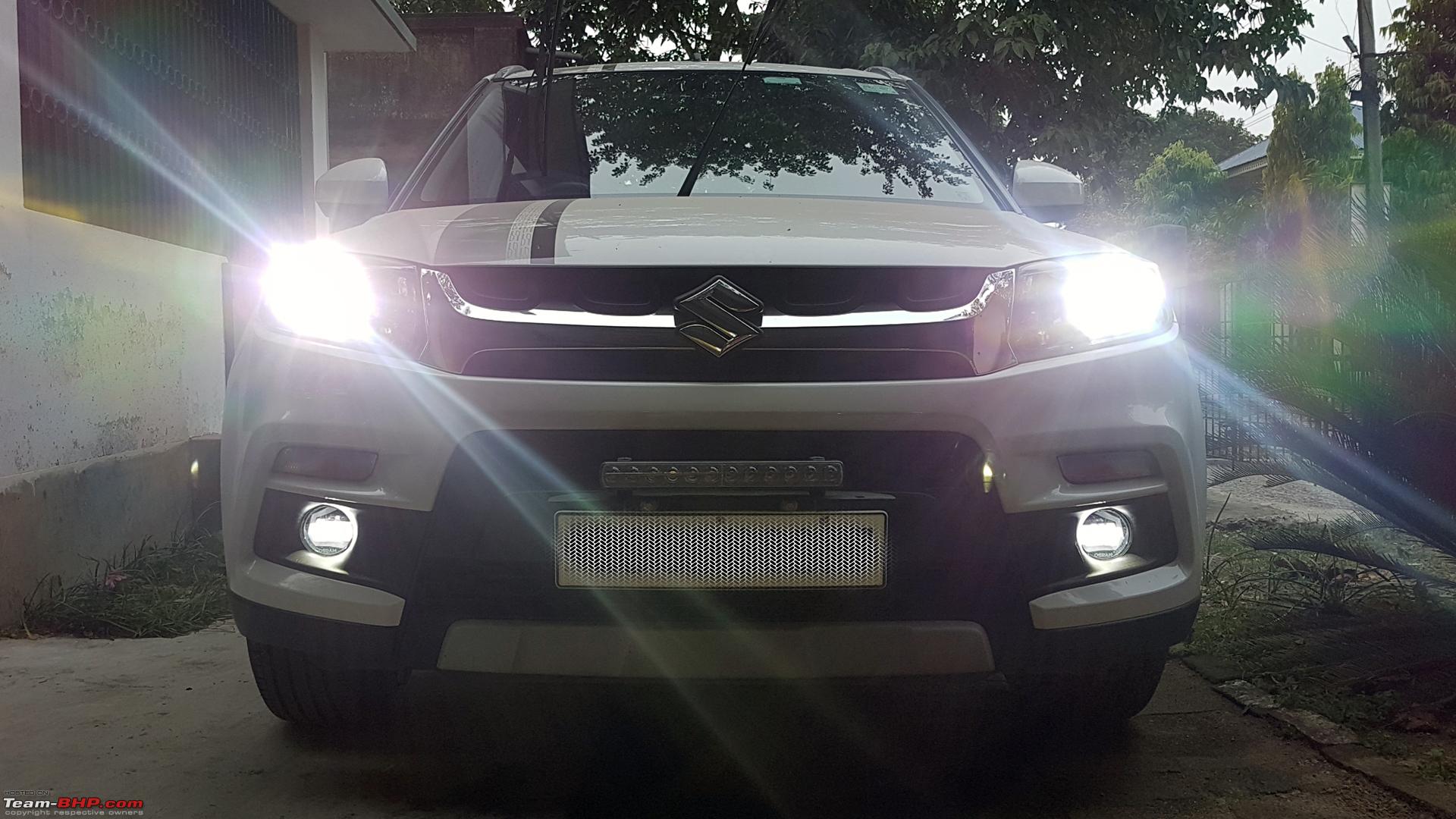

To start with, MS Vitara Brezza ZDi 2018 had very weak low beam output from its H7 halogen projectors. For a couple of months, I was entirely dependent on the Hella 350 LED light bars aligned down to add strength to the low beams. After trying my luck and getting disappointed with Philips H7 Xtreme Vision LED headlight bulbs, retrofitting them with Osram 4300K DH7 HID kit came as a blessing. It solved the low beam output from the factory projectors to a considerable extent and made highway drives safer. The 4300K colour temperature HID is really an all-weather light, as the 6000K ones often prove useless during rains. Initially, I was not getting a proper output and cutoff from these HIDs, but after a few rounds of alignments, the HIDs got a proper cutoff line and considerable output. The high-beams are healthy enough to churn out both power and throw.
The bumper-fitted DRL/Fog/Cornering LED lights are from Osram. They were fitted earlier in our Wagon-R and got shifted in the Vitara Brezza. Fog light output rated at 6000K is not that great, more so in rains, but the cornering light function helps and what helps the most are the DRLs. As the 2018 Vitara Brezza ZDi lacks any sort of DRL, the Osram ones do suffice and that too, with a discrete, OEM look. They also double up as hazard lights, throwing an amazingly bright streak of flashing lights with the hazards and also with lock/unlock via remote.

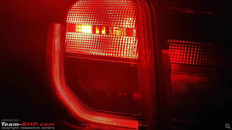

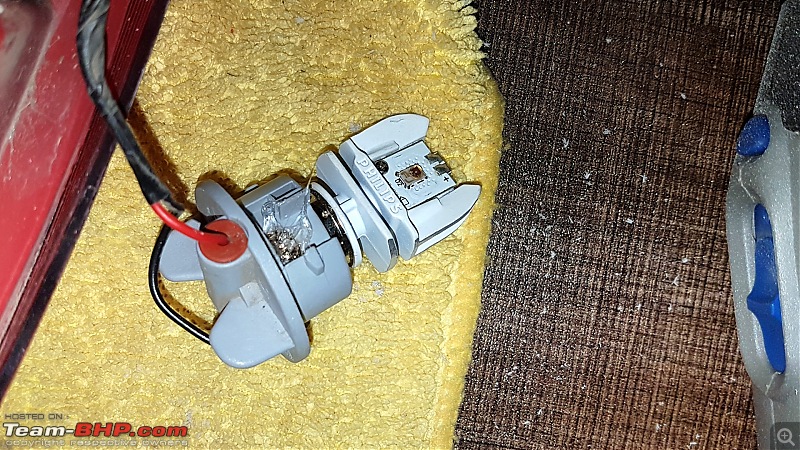

Upgraded the Reversing lights from incandescent T16 to Philips Xtreme Vision T16 LEDs. They are bright white and make reversing in the dark a breeze. License plate lights are now T10 LEDs from Philips. Rear looks premium!

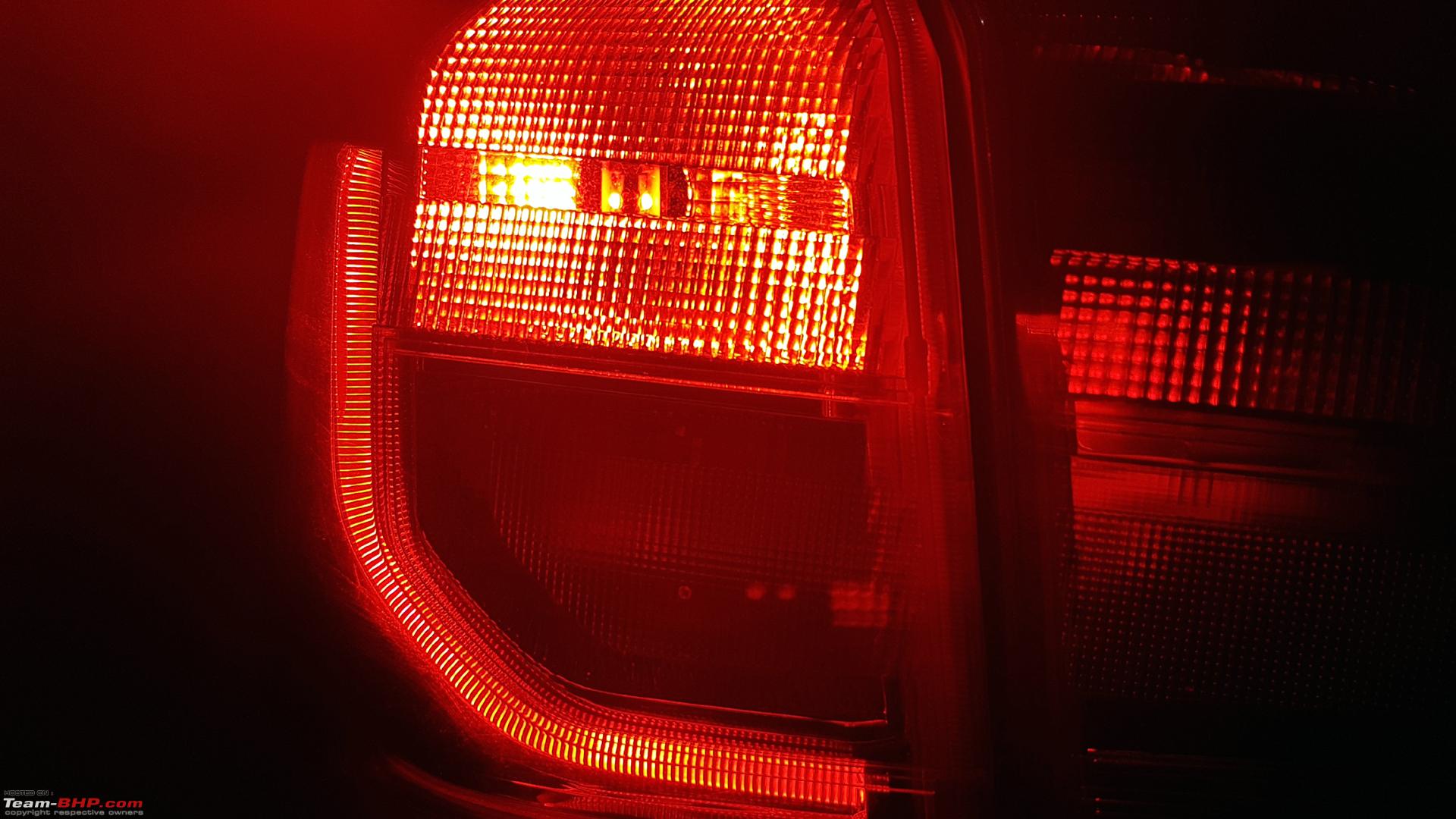

Incandescent P21W brake light bulbs were not that bright and responsive enough. Replaced them with Philips 1157 Xtreme Vision 1157 Red Rogue LEDs. Why not 1156(P21W)? Well, I had these 1157 (P21/5W) installed in my Wagon R earlier. To accommodate 1157 in 1156 holders in Brezza, I soldered the two poles of each LED bulb at the rear and made adjustments by trimming the plastic holders with a Dremel, so that the 1157 sits in the 1156 holders and the soldered & bridged poles get the positive current to illuminate both the low and high lux (21 & 5 poles together in P21/5W bulb). Result was really worthy. The brake lights now are super responsive, energy efficient (down to almost 2.5 watts from the earlier 21 watts) and blazing red.
Next in the pipeline are changing the indicators to LEDs, which may entail adding resistor loads; adding LED puddle lamps to all 4 doors; and if resource favours, I may get the headlights retrofitted from a competent person with quad-projector setup with G5 EXL & G5 BRT in combination, powered by Philips Xtreme Vision D2S and Denso ballasts.
Attaching a few pictures of retrofitting done by me on the Vitara Brezza.
Auto Lighting thread : Post all queries about automobile lighting here-brezzadrl.jpg
Auto Lighting thread : Post all queries about automobile lighting here-brezzafog.jpg
Auto Lighting thread : Post all queries about automobile lighting here-brezzafoghl.jpg
With additional Pictures
Auto Lighting thread : Post all queries about automobile lighting here-brezzahlcutoff.jpg
Auto Lighting thread : Post all queries about automobile lighting here-brezza1157led.jpg
Auto Lighting thread : Post all queries about automobile lighting here-brezzabrakelight2.jpg
Auto Lighting thread : Post all queries about automobile lighting here-brezzabrakelight3.jpg
Auto Lighting thread : Post all queries about automobile lighting here-brezzareverseparking.jpg

The Hella 350 light bar comes in 3 variants- pencil beam, flood beam and driving beam. The one I installed is a driving beam. Procured a Hella registration plate light mount from a retailer (sorry, don't have any photo of the mount) and bolted the mounting plate with the nuts provided for bolting the registration plate (now they are not bolted, rather are riveted) on bumper. The number plate was riveted on top of the mounting plate at the RTO office. The Hella LED light bar is mounted on top of the Hella mounting plate and adjusted to hit the high beam spot.
I hooked the positive wire of light bar with the stock fog light wiring positive and wired the negative through a switch from inside the cabin. This serves as a safety check wherein the light bar gets cut-off whenever the fog lights/parking lights are switched off, as one can forget to switch-off the bar which has no audible or visual alarms unlike the parking or headlight-on reminders while getting out & parking the vehicle.
In my opinion, just one 350mm light bar coupled with stock headlights is adequate for highways. The 470mm is definitely more powerful and you can surely go for it.
Regarding quad-projector setup, you can consider Morimoto/Profile/Osram Bi-LED projectors if you want a hassle-free, fit & forget experience. As opposed to Xenons, there is no warm-up time, and you also have the freedom to flash pass light without any harm to your ballasts. But the downside is that once any one projector unit goes wrong for whatsoever reason, you'll have to pry open the headlights. Also, the colour temperature from LED projectors don't go well with black asphalt roads, especially during rains.
To get a powerful bi-xenon quad-setup, you can consider installing four Morimoto D2S 5.0 or G5-BRT and EXL in combination, alongwith Osram nightbreaker unlimited laser D2S or Philips Xtreme Vision Gen2 D2S lamps with Denso or any good ballast to get the dream-output you want. Generally, 4200-4800 K colour temperature provides an all-weather visibility.
You can opt for Hella Nighthawk 90mm H7 halogen fog lights if you want a wide, floodlight setup with decent light output at a modest price. Projector fogs are also good in terms of performance, but are a bit costly than regular fog units.
sumitmajumdarin is offline   (3) Thanks
