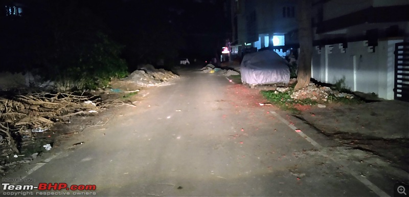

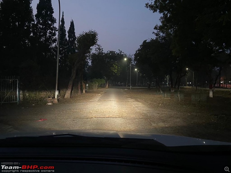

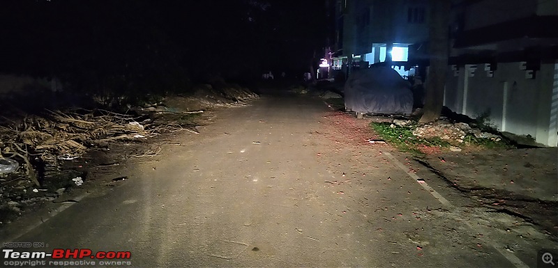

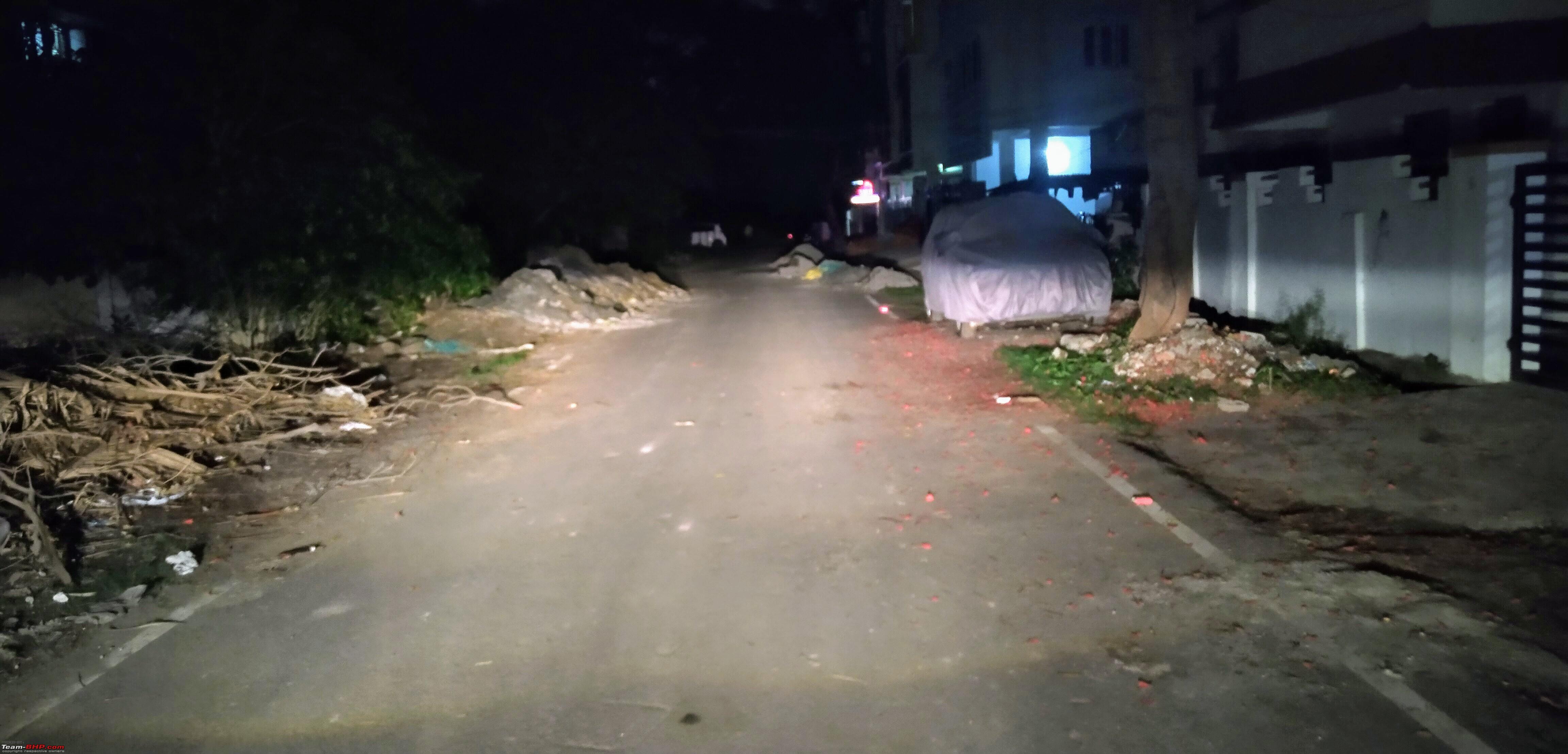

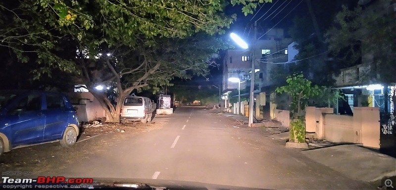

Hi Guys,
I had previously posted what I had done for lighting improvement on my pre-facelift 2017 Ecosport.
Now, I am sharing the steps on what I have done in the new Facelifted Ecosport for improving the spread of low beam and throw and coverage of the high beam using the stock bulbs. This was done on my friend’s vehicle; then my cousin’s vehicle and recently on one of the members in the ford Ecosport whatsapp group. So, I can say with certainty that this is easily do-able with a little bit of care and attention to detail in a dark road.
This way, the new car buyers can have optimal light output even with the stock headlamp setup without going for higher wattage bulbs, LEDs or HIDs.
This procedure is same across all the vehicle variants right from Ambiente to Titanium+. Am not sure of how it is in the “S” variant. If the tabs for alignment are available in same position, then the same procedure should be applicable to those variants as well.
This procedure is to be done on your own risk. If you are unsure how to get this done; then seek the help of a professional. Always keep a track of the steps you have completed on each alignment tab (no. of turns on each tab, with direction of rotation). This way, you can always revert back to OE settings should you prefer in the future or if you need to realign a new headlamp fitted in future (after damage replacements, if any).
Some Light Output shots before & after alignment (not all in the same location; but from the same car). This car is running with stock bulbs on all lamps. No HID / LED kits.
Except for the fist photo (Stock low beam); all photos are taken keeping headlamp leveler at ZERO.
Stock Low Beam - Head lamp leveler kept at 2 due to mistake - don't have another photo of this view with me. My Bad.
Auto Lighting thread : Post all queries about automobile lighting here-stock-low-beam.jpg

Dark Road – Low Beam
Auto Lighting thread : Post all queries about automobile lighting here-dark-road-low-beam.jpg
Dark Road – High Beam
Auto Lighting thread : Post all queries about automobile lighting here-dark-road-high-beam.jpg

Lit Road – Low Beam
Auto Lighting thread : Post all queries about automobile lighting here-lit-road-low-beam.jpg
Lit Road – High Beam
Auto Lighting thread : Post all queries about automobile lighting here-lit-road-high-beam.jpg

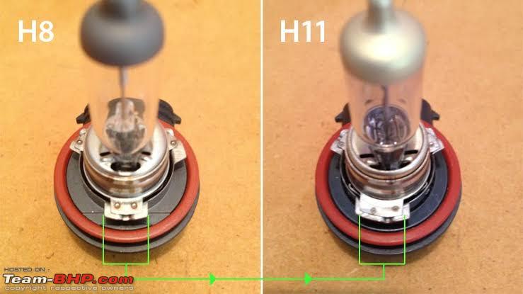

Another small hack for the new Ecosport - The fog lamps given by the company are weak 35w H8 bulbs. This can be replaced with H11 55w bulbs very easily. The marginal current draw increase will be handled by the two separate 20A headlamp fuse on each side without any issue.
Simply buy a H11 bulb and trim the wider tab of the H11 bulb to match the size of the H8 bulb. The connector remains the same for both; so no issues there.
Auto Lighting thread : Post all queries about automobile lighting here-h8-vs.-h11.jpeg
