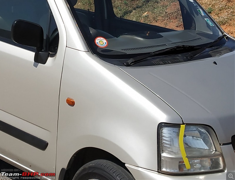

Originally Posted by shivamk11 View Post
I am sorry but doesn't the 130/100W bulbs have tendency to burn the reflectors and cause issues?
I realised that the URL that I posted is for 130/100 and not 90/100.
Regarding blackening or fading of reflectors, it is a case with quite a few cars that I have seen but I would say that it depends on your usage. Most of the road users we around drive on high beams with that 130/100 set-up all the times.
As for me, I have the same set-up in 2 of my cars and both have run on this set-up for nearly 2 Lakh Km each and my reflectors are stock. There is no such fading or blackening as a result of using these bulbs and whatever it is is purely age related.
This is from a car done 250K Km and with 100/90 set-up since 200K Km and still on stock reflectors:
Auto Lighting thread : Post all queries about automobile lighting here-exterior-2.jpg
paragsachania is offline   (3) Thanks
