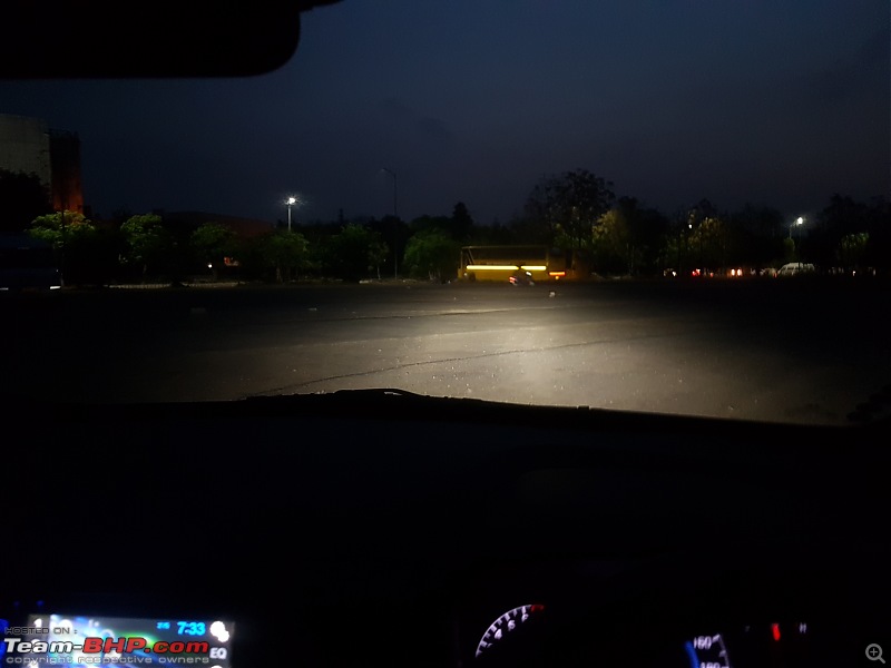

So its been a while since i did a DIY on installing Bi Led projectors and i am quite satisfied with their performance till now. Here are a few output pics and a driving video taken from my dashcam. This setup costed me around 15k due to my newbie mistakes although it could have been 14k. If anyone needs help in a DIY feel free to PM me. I'l ensure my mistakes aren't repeated. The projector model is Pjx /iLens 2.0 that i got from alibaba. Morimoto also sells the same item with their branding.
The cutoff is slightly sloped and not perfect but not much can be done for it as headlight doesn't allow rotational adjustment.
I would also love to have a comparison with a factory fitted Led headlight setup from midrange cars like baleno and city which come with led lights as well. So if anyone game to do a comparo do let me know, i stay in central gurgaon.

Your setup is quite bright and looks good. The cutoff lines are fine and this is how they should be. Only one observation is that your hot spots (bright spots in the beam) are too bright and the light distribution could have been more spread out and even. With this distribution it is possible you may miss objects in the peripheral areas due to too much light on the bright spots. But that is difficult to judge from camera shots as our eyes behave quite differently from cameras. If there is any adjustment of forward/backward setting in the projector to change the focus, try changing it a bit reduce the hot spots.
The hot spots aren't that noticeable in actual use and actually make driving better on highways where beam needs to go far down the road. Cameras somehow really brighten it up.
