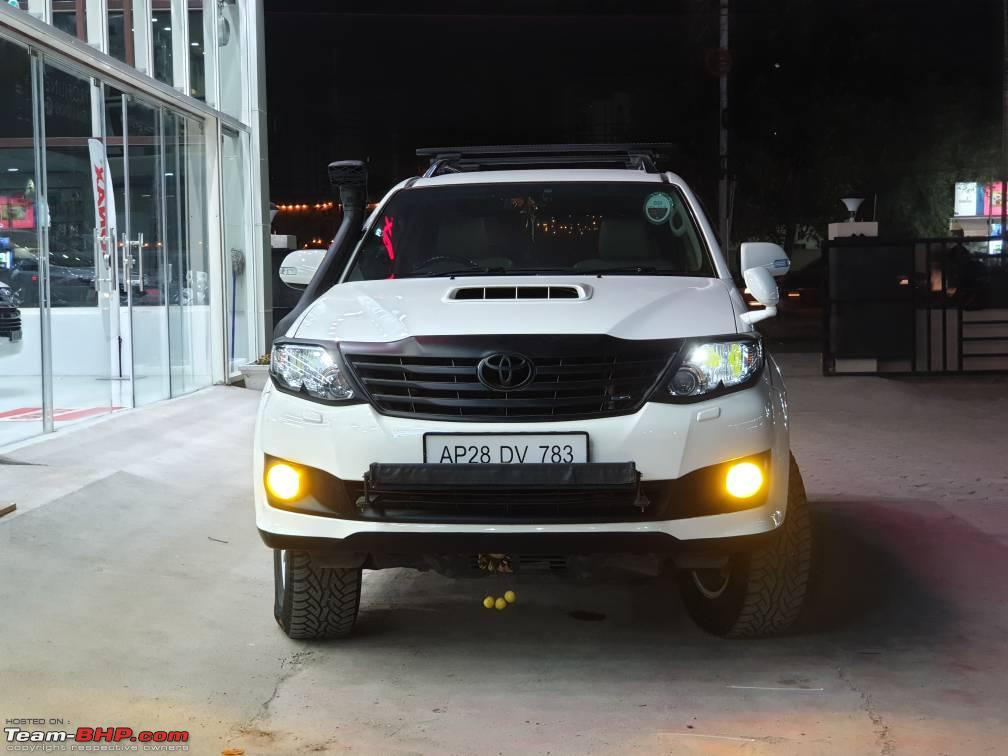

I have installed dual LED fog bulbs in my Fortuner recently. It offers two throws of white at 6000k and yellow at 3000k. Takes care of rainy and foggy weather conditions, as required.
Looking good. You installed a separate switch in dashboard to take care of the 3000k and 6000k switching?
It is one LED bulb with two color emitting LEDs. First time I put on the fogs, white color is turned on, if I turn off and turn the fog lamp rotor switch on the stalk on again, yellow color comes on. So, no separate switch is required.
