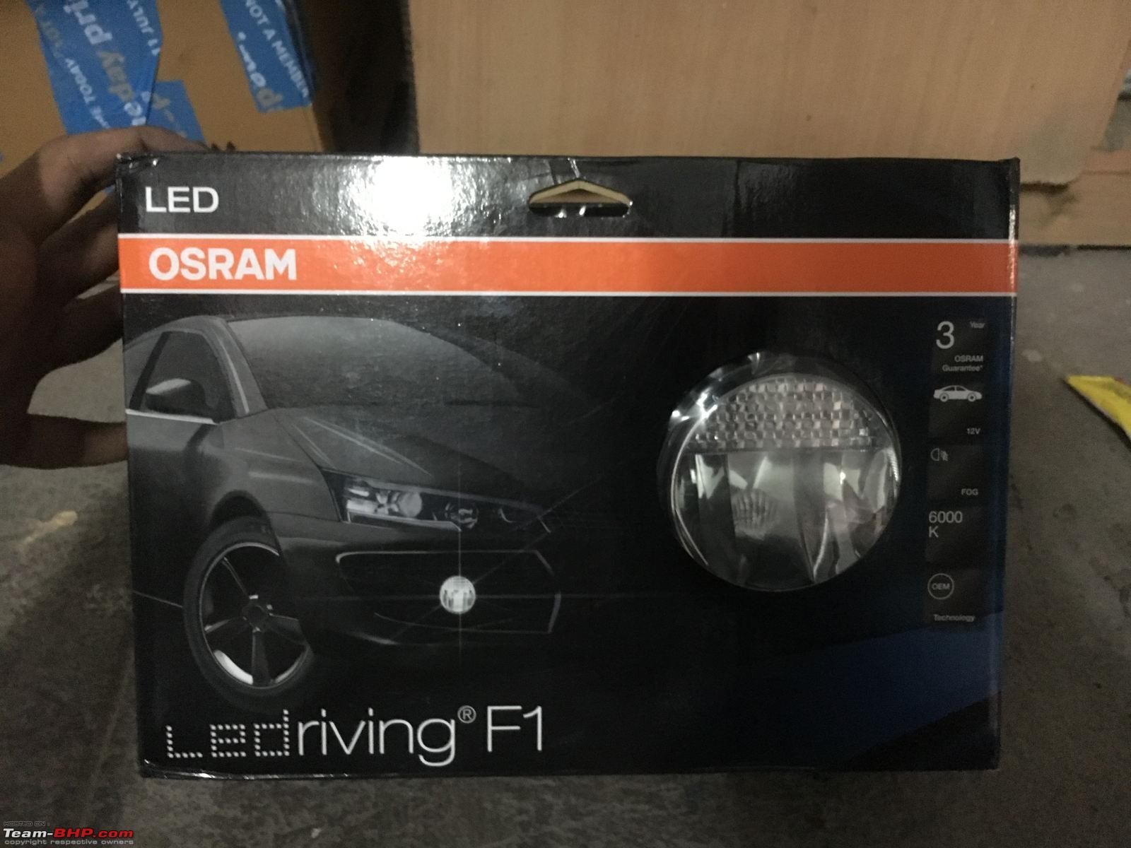

Product review: OSRAM LED Fog lamp 201
Browsing amazon on a random day, I found this product at a very attractive price http://www.amazon.in/Osram-LED-Lamp-...ilpage_o00_s00 which was earlier retailing for around double that price. Having used LED fog lights in my Celerio, I thought of swapping the OE fog lights on the SX4 with this one. Hence, ordered it and it arrived next day:
The product was well packed as usual and I unboxed it.
Auto Lighting thread : Post all queries about automobile lighting here-13.jpg
Auto Lighting thread : Post all queries about automobile lighting here-10.jpg
Contents were simple - a pair of lamps with wiring inbuilt, cable ties and instructions.

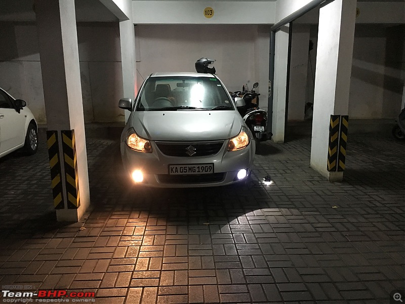

Here are a few pictures post installation. Wasn't really something I would have created a detailed thread as many have installed this and wiring is pretty straightforward. The one which was difficult (Ignition) is explained above anyway.
The DRL:
Auto Lighting thread : Post all queries about automobile lighting here-20170714_070716.jpg
Fog Lamp:
Auto Lighting thread : Post all queries about automobile lighting here-20170714_070749.jpg

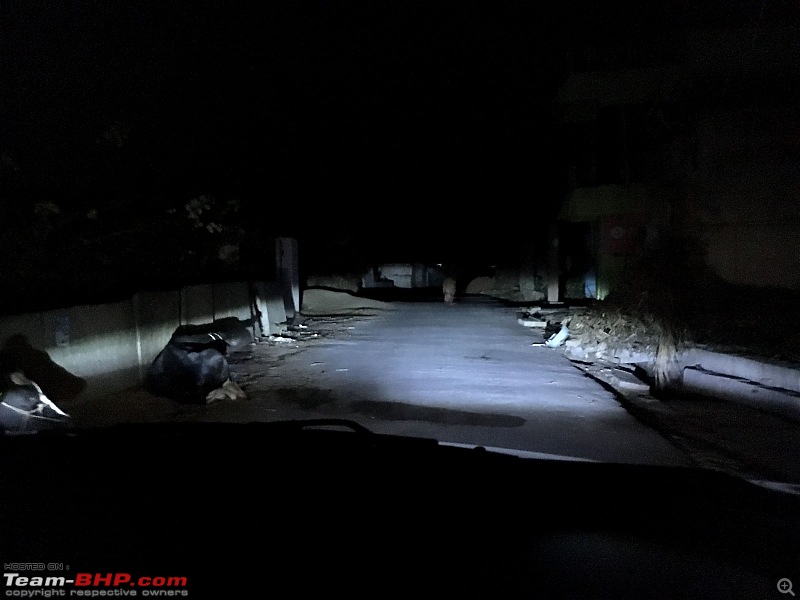

The throw from the Fog lamps, adjustment needs to be done which I am yet to complete:
Auto Lighting thread : Post all queries about automobile lighting here-20170714_070800.jpg
Auto Lighting thread : Post all queries about automobile lighting here-20170714_070737.jpg
Are these useful at all?
Well, let me be brutally honest. The Fog lights are improved but not with a great margin.
Will these aide me on my regular drives at nights on single carriageway unlit roads and ghat sections in rains or fog ? Not really. I am more than just happy with the 100-90 H4 upgrade using which I continue to drive on such roads at usual speeds.
However, I am more than happy with the way this functions : Gives almost an OE Look and the controller supplied with it makes it a very efficient system overall whenever you want to use the DRLs or Fogs.
