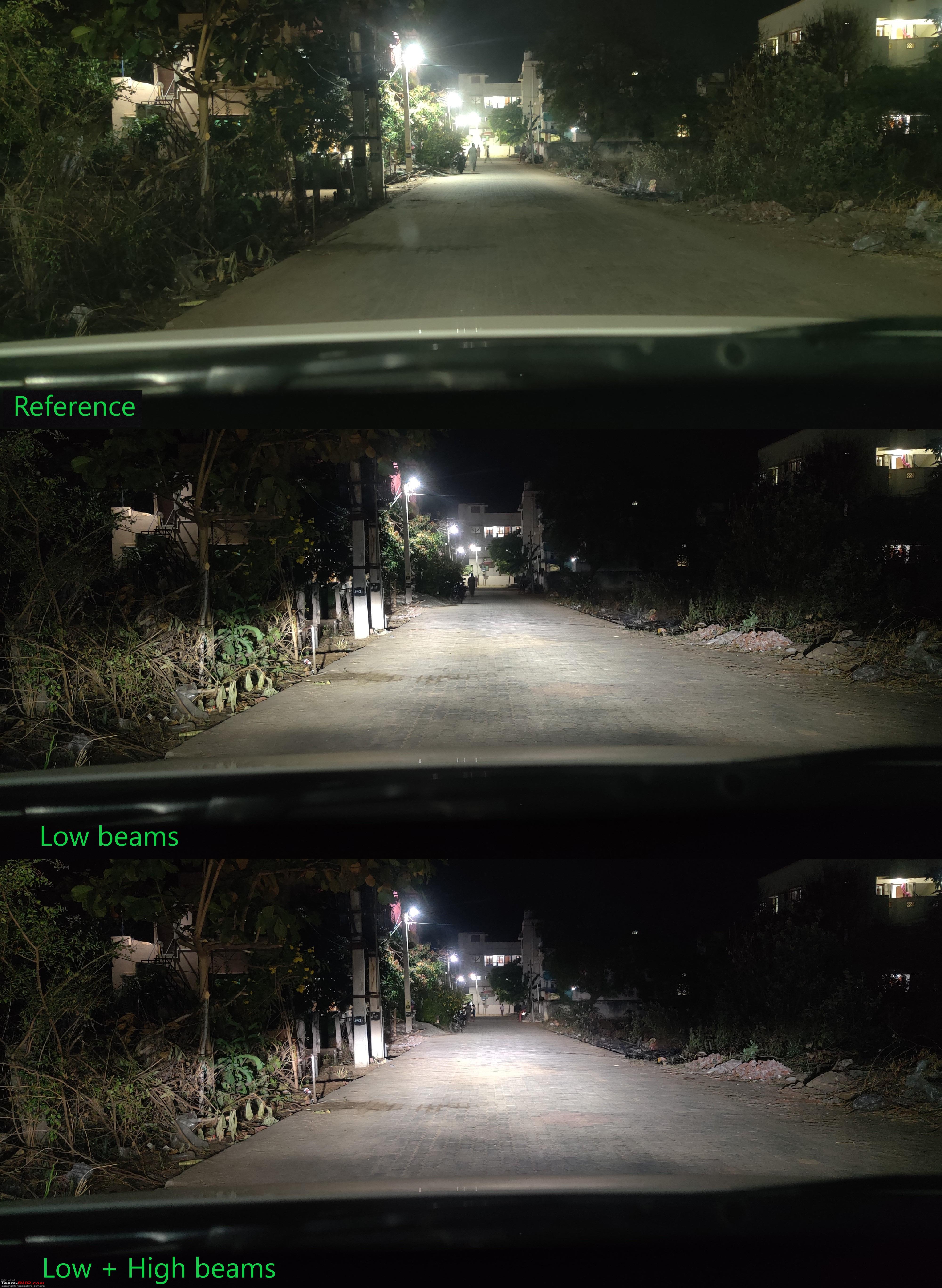

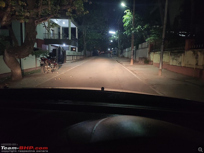

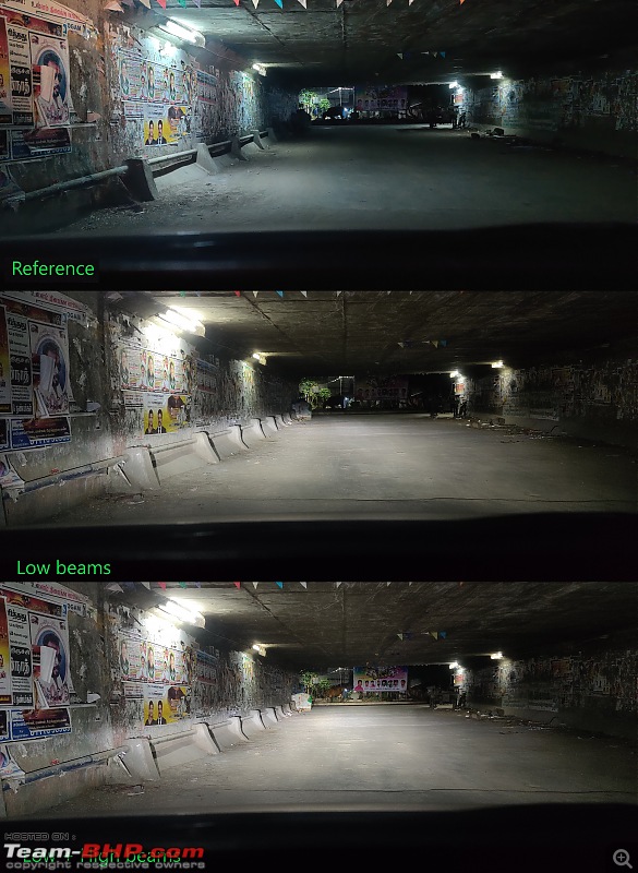

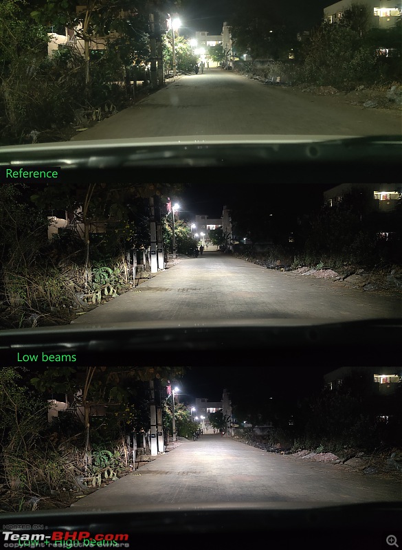

Morimoto 2Stroke 3.0 H7 LEDs in a reflector housing
I picked up a pre worshipped VW Ameo DSG in Sep-2020 [Dec-2018 registered with 37k on the odo, currently at 44k]. I do frequent highway runs between Chennai - Trichy and was longing for better lighting. I will start with the results and then the details.
Results: I have captioned the pictures below for clarity. Pictures were taken with a Oneplus 7. The phone was placed on the center of the dash and was leaning on the windshield. The photos are not altered but they do appear brighter when compared with the naked eye. These were results with H7 LEDs on reflector housing.
Auto Lighting thread : Post all queries about automobile lighting here-1_low-beams.jpg
Auto Lighting thread : Post all queries about automobile lighting here-2_low_and_high.jpg
Auto Lighting thread : Post all queries about automobile lighting here-3_dump.jpg
Auto Lighting thread : Post all queries about automobile lighting here-4_dump.jpg
Auto Lighting thread : Post all queries about automobile lighting here-5_road.jpg
Auto Lighting thread : Post all queries about automobile lighting here-6_tunnel.jpg
Details: I did not want to do anything that impacted warranty nor blind oncoming traffic. After research I zeroed in on Morimoto 2Stroke 3.0 LEDs, they are 5500K. They are designed to mimic stock halogen headlights to mitigate light bleed. These were only launched in ~Nov-2020. They fitted comfortably in the Ameo headlight housing and did not cause any warning lights in the dash. However fitting them took some effort. The stock clips used by VW to house H7 halogens cannot house an LED and the LED adaptors bought from Amazon worked well only for the low beam housing. The high beams were fitted with some juggad by trimming the stock metal clips. I am not entirely happy with how the high beams have turned out (Are they too low?), I think the clips are the problem. Does anyone has a suggestion for H7 LED adapter that works well in a high beam housing of Ameo/Polo/Vento?
Next I need to color match the fog lights with an IP67 rated LED

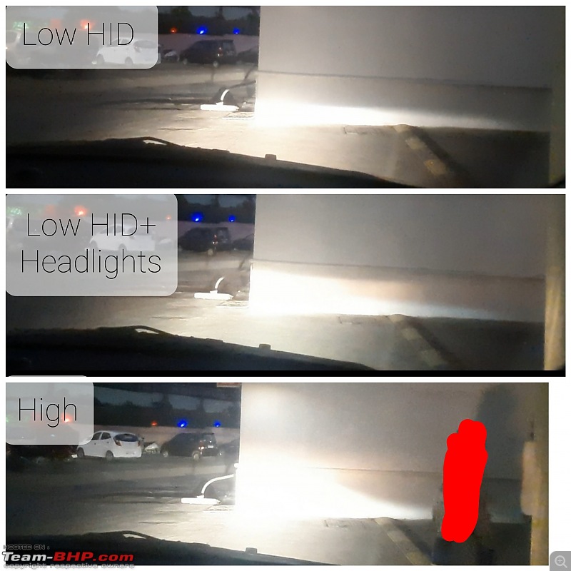

Auto Lighting thread : Post all queries about automobile lighting here-collagemaker_20210420_213041021.jpg
To all, can you guys give me an idea about the superior limit/cutoff for fogs? Also, as you can see, when I switch on to high beams, there's a small spot high above the cutoff. Any idea why?
Torq is offline
Rotate the bulb slightly in either of the directions (clockwise or anti-clockwise) and see if that spot disappears or not or maybe changes the position.
Old 20th April 2021, 23:59   #12056
Kosfactor's Avatar
Join Date: Oct 2018
Location: COK\BLR\MYS
Posts: 3,897
Thanked: 11,296 Times
You need to spend some time in the night to get this beam adjusted properly, whatever additional light you add needs to work with the main headlamp beam, else it will disturb your vision.
Kosfactor is offline   (1) Thanks

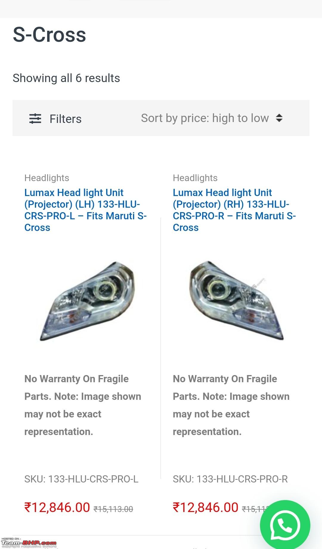

Old 25th April 2021, 10:33   #12057
Join Date: Aug 2019
Posts: 148
Thanked: 443 Times
Greetings,
I have an S cross Zeta and the headlight output is weak.
I upgraded to Osram Night Breaker Laser H 7 bulbs whose output is slightly better, but I still yearn for more.
I'm contemplating of upgrading to S cross Alpha variants' headlight assembly. But, a pair of them are priced close to 50 thousand.
I have come across Lumax Headlights priced at approx 13k each.
Has any bhpian used it on their car?
If yes, then how is the output.
Thanks in advance.
Attaching image for reference.
Auto Lighting thread : Post all queries about automobile lighting here-screenshot_20210425102024__01.jpg
matchvan is offline
Thanks in advance.
Folks on this forum were not very happy with the stock HID headlamps of the Alpha variant too (search on the S-Cross review thread). For this upgrade, you might have to change the wiring too and in my opinion, it is not worth the investment.
I would rather suggest HID projector fog lamps which several owners have upgraded to and have been happy with the final output (again, search the forum and you will find more details). I have seen one such Alpha variant with HID projector fog lamps. In terms of performance, the fog lamps outshine the headlights by good margin.
ashis89 is offline   (2) Thanks
