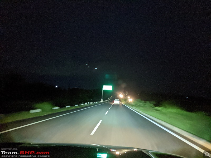

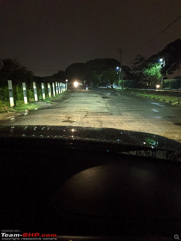

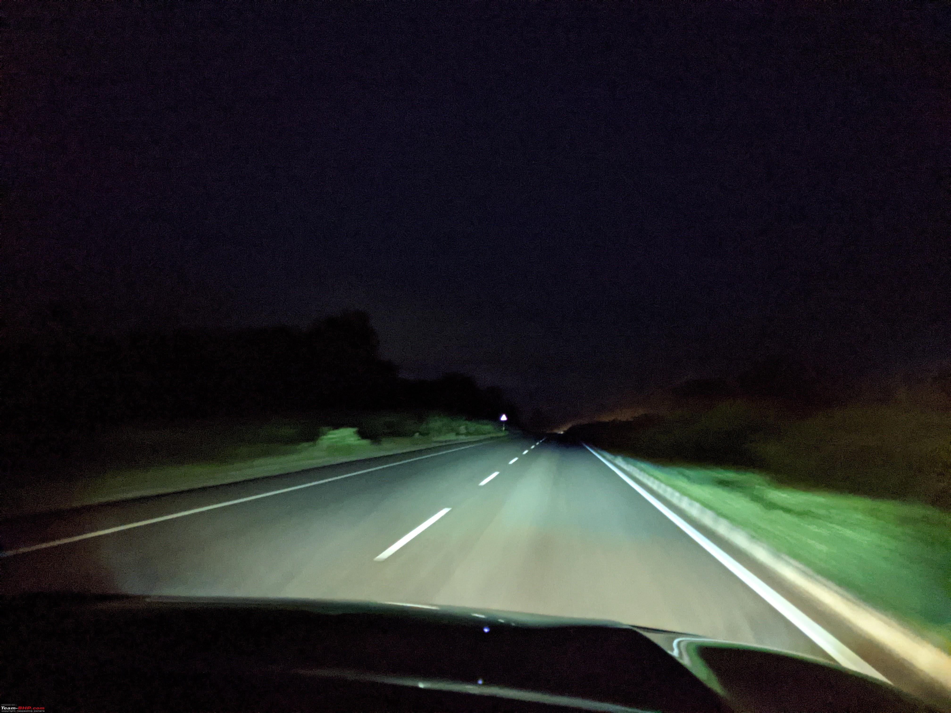

Happy to hear you have good experience with the LED in projectors. Please share some pics for everyone's knowledge.
Two major advantages would be reliability and ability of flashing the high beam spontaneously.
2. Colour temperature: 6000K is fine for metallic and non metallic roads but fails drastically in rainy drives as well as on the freshly laid tar roads that are pitch black. I haven’t tested them in fog so far. The colour is fine for 80% of the applications but at the same time it is totally unsuitable for rest of 20% of scenarios.
Again, please share some pics of the LED performance on wet roads.
HID is no saint here. But it's miles ahead of the performance of stock halogen under similar condition. Another con of projectors is their performance is highly impacted by a dirty headlight, especially muck on a rainy day
Some pics of HID performance in wet roads

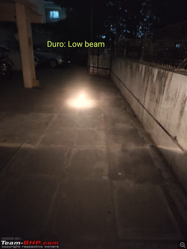

Query about two wheeler headlight:
The headlight of my Mahindra Duro always felt insufficient and not spread properly. When I ride in the dark, I see the light focussed more on one spot and not spread enough over an area.
Here is the comparison of the lights from the two scooties standing side by side. Let the pictures do the talking.
The pictures are taken after changing the headlight bulb of the Duro. This is 2011 model with stock reflector and lens. This lense has yellowed a bit but it has very few scratches compared to my Jupiter. I had restored it reasonably using polish paper and clear coat.
Request the experts to suggest remedies. I have already ordered a new headlamp assembly and it shall be fitted in 2 - 3 days.
The problem with DURO looks like a bad reflector design. Have you checked with other DURO's? Do they have a better/different throw of light?
TVS headlamps have one of the best reflector design in Indian market, resulting in a good spread and focus. I have observed this among all their scooters and bikes.

That duro does seem to be a bad reflector. Is that how its been ever since you got it? If not, then you should check with another duro, maybe you need a new reflector itself.
And that Jupiter's low beam cut off is much too high. You might want to get it lowered to about window line on the car in front.
