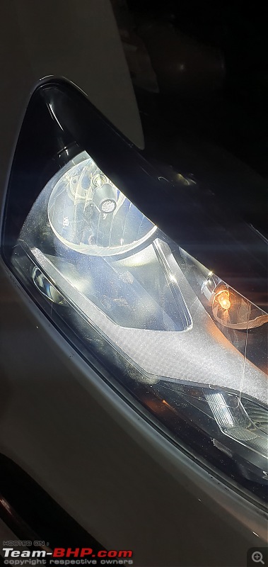

Just upgraded the low beam on my Polo to Osram LEDs H7. Quite satisfied with the results so far. Just tested it out in the apartment complex, so a real world dark road test is due. The throw of the LEDs is much better than the stock halogens.
Pending: Osram night breaker laser in high beam. Don't want such a cold temperature in high beam.
Here are some pictures.
Close up:
Auto Lighting thread : Post all queries about automobile lighting here-20211222_212643.jpg
White light does suit the overall look:

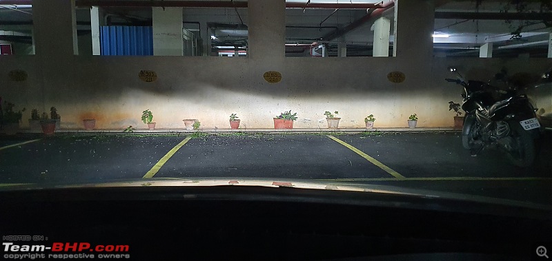

Comparison of low beams:
1)
Auto Lighting thread : Post all queries about automobile lighting here-20211222_214736.jpg
2)
Auto Lighting thread : Post all queries about automobile lighting here-20211222_214644.jpg
Question to the forum - Why does the cutoff look jagged on the left side? I made sure the LEDs are pointing 90° and 270° inside the housing. Could it be the reflector housing?

Happy to hear you have good experience with the LED in projectors. Please share some pics for everyone's knowledge.
Guys, aftermarket LED in stock halogen projectors is not a good idea.
I had perceived the sharp LED lamps in stock halogen projectors to be good without having an actual 1-to-1 comparison with stock halogens.
Yes, LEDs are a lot more brighter and strong, however, they lack in the spread that stock halogens provide.
So, I believe the right upgrade for halogen projectors is either HIDs or special aftermarket LED lamps that are specifically designed for projectors (very few options in the market).
I’m speaking from my own experience since right now, my left headlight is aftermarket LED while the right headlight is stock halogen (both in stock HB3 projector setup). I ended up with different lights setup due to an accident.
sarav100 is offline   (2) Thanks
Yes fully agree on this. If the car has halogen based projectors, the best possible upgrade is HIDs in 4300k in 35w or 55w (depending on your requirements). With 35w HID you will get 2x light level and with 55W you will get 3x light level. But with 55w the risk is higher inrush current and also very high glare to other cars. 35w is generally good enough for most users.
With Hids the benefit is that the light distribution is 360 degree (apart from small ground wire) so there are much lesser dark spots in the beam. In case of leds the beam is interrupted by the heat sink plate which cuts off almost 30 degree beam on both top and bottom as most leds are installed with heat sink plate in vertical condition.
Also the beam focus with HIDs with projector remains same (or better) as compared to the halogens.
Attachment 2248575
This beam pattern appears to be normal for a low beam reflector, it should be slightly higher on the left. If you have placed the LED perfectly perpendicular within the housing then you are good. I am not sure if there is a light bleed/glare from the Osrams, this can be checked if you have reference shots with halogens.
I am attaching pics from my Ameo with LEDs as a reference. I use Morimoto LEDs, so the beam pattern can be slight different from your Osrams.
Attachment 2139939
