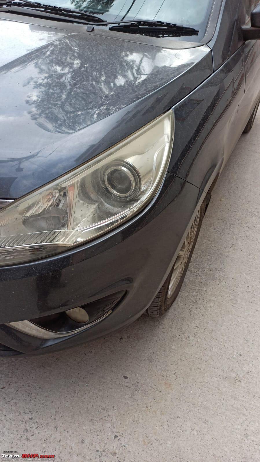

Even I am looking to put in an H7 LED in my low beam projector. Current Hilux HID 55 watt ballast with 5000k yeaky)Uglare bulb has burnt and faded the crome in projector bowl, and due to hole in dust cap Water, humidity and dust has damaged the housing which I had to get restored at Shivaji Nagar BLR, but Chrome of the Projector bowl couldn't be restored. It has made situation better now. This time I don't want anything comig in/out of Housing (namely wire) so want to put LED headlight bulbs (preferably all in ones without separate driver box) so that I can seal it in. This "only 6000k colour temperature LED available" epidemic is really horrible. I don't know what to do. At one local shop square pattern LED source Braided passive heatsink design LED bulbs are available in 4300k but I never heard of the company. I prefer warm white light over bluish white ones. I am overall happy with H1 CSP singe rowl led bulbs in my high beam reflector since over an year. They are lot more focussed than earlier CREE XHP 50 based ones. (It's 6500k, and I don't like rain performance though). Unfortunately same product is not available any more. I guess global chip shortage is affecting this too.)
The H1 ones in my high beam.
Auto Lighting thread : Post all queries about automobile lighting here-screenshot_20220821013458383_in.amazon.mshop.android.shopping.jpg
Headlight being opened and restored. Do note the lack of shine in the bowl.
Auto Lighting thread : Post all queries about automobile lighting here-img20220821wa0001.jpg
The condition of headlight assembly had become horrible and I want to avoid repeat of that.
Auto Lighting thread : Post all queries about automobile lighting here-img20220821wa0005.jpg
Auto Lighting thread : Post all queries about automobile lighting here-img20220821wa0003.jpg
Auto Lighting thread : Post all queries about automobile lighting here-img20220821wa0004.jpg
Auto Lighting thread : Post all queries about automobile lighting here-img20220821wa0002.jpg
Post restoration visibility is better, but it's still on led H1 in high beam, and HID in low beam projector. In all this somehow low beams have got misaligned and pointing too much downwards limiting cut-off distance.
If I have any update, I shall post here later.
