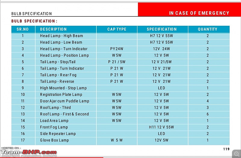

Hi all, I am looking to upgrade the bulbs of my Zen Estilo 2008 & Tata Aria 2012. Apologies for the long read.
Background info / requirements for the Aria :
1. The Aria has a dual projector setup for low and high beams and the low beam especially needs upgrading.
2. I'd like to ideally purchase something from Aliexpress that doesn't conk off quickly but at the same time is cheap-ish
3. The color temperature should be yellow / halogen like
Questions :
1. As this is a projector setup, would HIDs be better? Or would LEDs be cheaper and more suited?
2. I also want to replace the fogs with HIDs or LEDs, again yellow color temperature
3. Lastly, I want to replace all parking, reading, tail lamp, puddle lamps, cabin lights, licence plate lights to LEDs. I've attached the bulb specs
Background info for the Estilo :
1. I have Philips extreme vision in both the headlamps (OEM was 12V, 60/55W H4 in reflector housing)
2. I also have Osram night breaker in fogs
The fogs are performing well but the head lamps could do with some improvement.
Requirements :
1. Cheap but good quality LEDs for the headlamps and fogs which don't involve cutting up the headlamp rubber seals. Again, yellow color temperature needed
2. I don't want HIDs for the Estilo as my past experience shows too much of scatter in reflectors (this is with Xenos brand HIDs with relays, one bulb stopped working after 1.5 years)
Please can experts share some Aliexpress /Amazon /Flipkart links?
I'm thinking of buying during the Black Friday sale.
Auto Lighting thread : Post all queries about automobile lighting here-screenshot_20191126225604113_com.mobisystems.editor.office_registered.jpg

Cheap and good quality do not combine well.
Halogen bulbs are around 3500K color temperature. It is not possible to get a LED at that temperature. You do get 3000k LED's but those would be Yellow.
I would recommend the below bulbs for your Aria. They have slight yellow tinge and are very bright with hot spot in the middle. They do not have a seperate driver module ,so it is easy to fit them inside the covered bulb area.
https://www.aliexpress.com/item/3290...yg_494568265.0
For converting other lamps to LED's go for bulbs from CNSunnyLight brand on Aliexpress. They are good and do the job well.
PS: Do not change the indicator bulbs to LED's.Will result in rapid flashing .You need to change the flasher relay or add a resistor in series with the bulb. Not worth the effort for the result

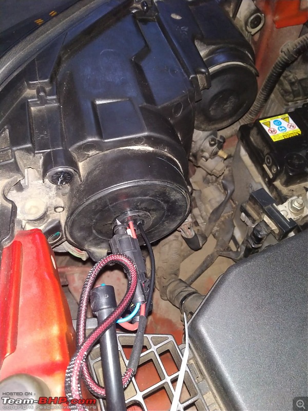

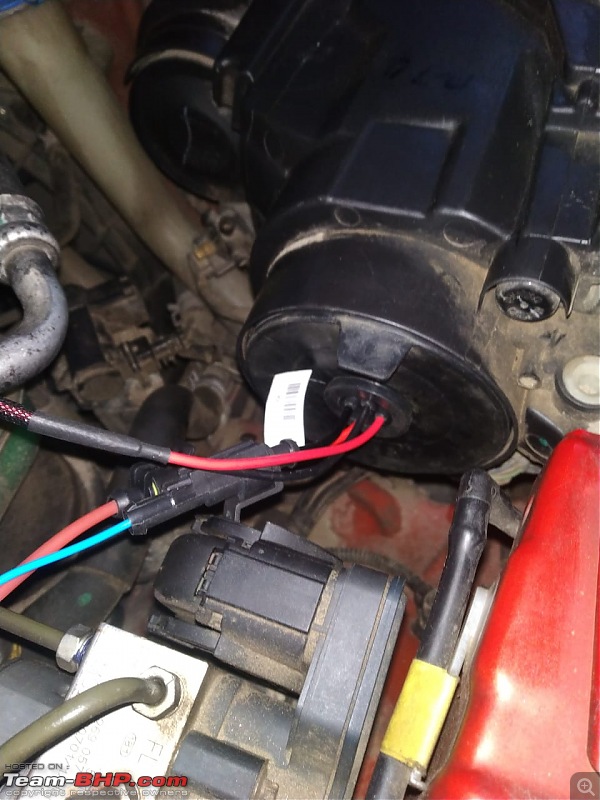

For the first Generation Ciaz that came equipped with Halogen bulbs with Projectors, I had successfully upgraded the headlights of one of my friend's car to HID with a conversion Kit from Osram.
Installed OSRAM HID conversion for Maruti Suzuki Vitara Brezza:
The experience from the Ciaz installation was excellent for the money spent. It was no brainer that for Brezza too, which runs on the same set-up for low beams, this would be a sensible upgrade without a fuss. Did that for a friend this morning and here are some work in progress pics along with the final output.
a. Drill bit for making a hole on the dust cap
Auto Lighting thread : Post all queries about automobile lighting here-01-bit.jpg
b. Brezza's dust cap are of rubber unlike Ciaz that uses plastic
Auto Lighting thread : Post all queries about automobile lighting here-02-dust-cap-before.jpg
c. Drilling in progress
Auto Lighting thread : Post all queries about automobile lighting here-03-dust-cap-hole.jpg
d. Both the dust caps ready to pass the couplers through them
Auto Lighting thread : Post all queries about automobile lighting here-04-dust-cap-after.jpg
e. After passing the couplers, and securing the hole with Orsam provided caps
Auto Lighting thread : Post all queries about automobile lighting here-05-cables-through-dust-cap.jpg
f. Ensures no dust or moisture enters through this set-up
Auto Lighting thread : Post all queries about automobile lighting here-06-cables-through-both-dust-caps.jpg
g. Harness ready for installation (simple plug and play)
Auto Lighting thread : Post all queries about automobile lighting here-07-complete-harness.jpg
h. Right hand side
Auto Lighting thread : Post all queries about automobile lighting here-08-rhs-hid.jpg
i. Left hand side

Note: Before connecting the couplers to make the harness, ensure that for Brezza you need to first pass the couplers through the spring/clip that secures the bulb due to a design reason.
While in the Ciaz the securing spring for the bulb had a design such that one could place the HID bulb and then lock (more like a C and open on one side), it was not the case with the Brezza's spring (more like U and closed from all sides). The design ensured that we had to first pass the couples and wires through this spring first and then place the bulb and lock it in place.
The below image from the owner's manual gives you an idea on what I am referring to. I could have tried to remove the spring, place the bulb and then fix the spring back and lock it but knowing that any effort to twist or pull that may have damaged the delicate location on the headlamp unit or even broken the spring as well. So it was a wise decision to pass through the couplers first and then place the HID bulb and lock it.
Auto Lighting thread : Post all queries about automobile lighting here-bulb-securing-spring.jpg
Product link: Osram HID conversion Kit
Before I forget, even though this was Amazon fulfilled order, the contents in the box had missing brackets to fix the ballasts. It was revealed only when I checked the box when my friend arrived. Hence, we secured these ballasts with Nylon zip ties in the engine bay area leveraging many of those unused holes around here.
