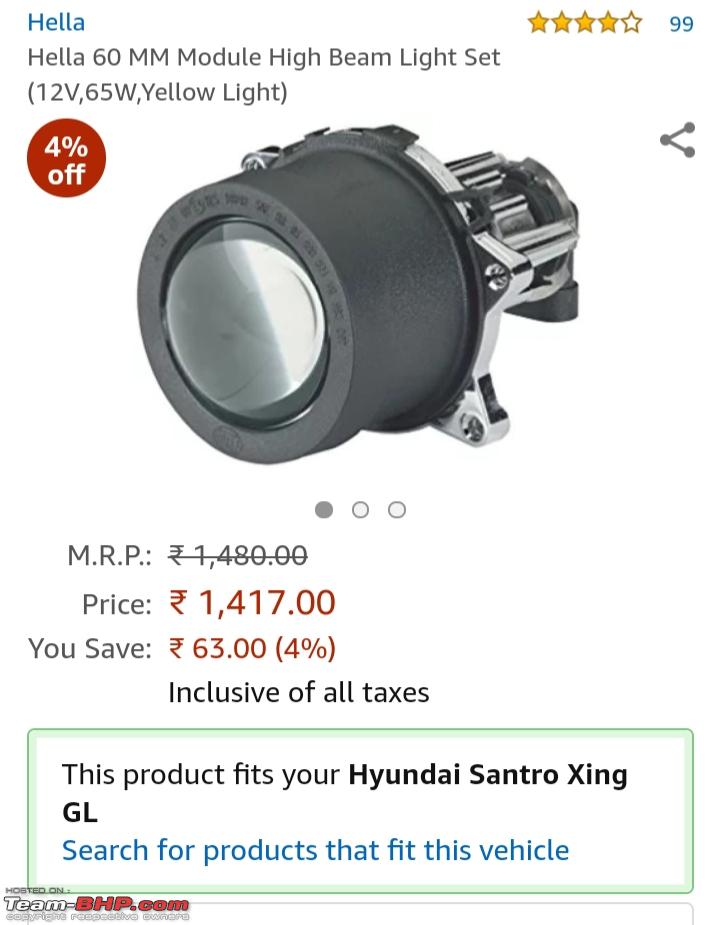

Came across Hella 60mm module projector fog lights. Amazon says it will fit in my Santro Xing. Any experience regarding this particular set of fog light?
Attachment 1903139

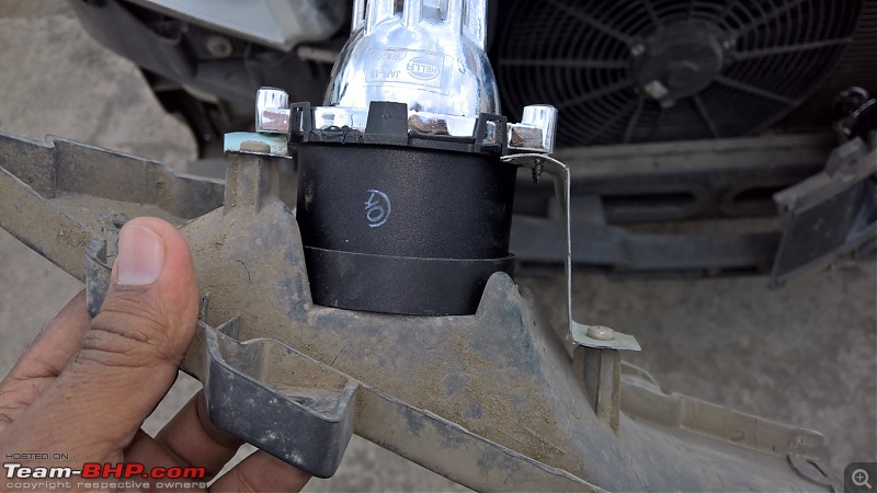

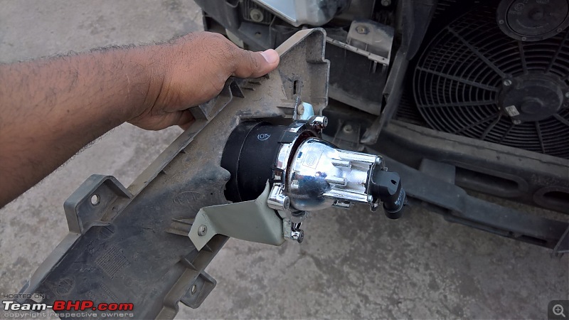

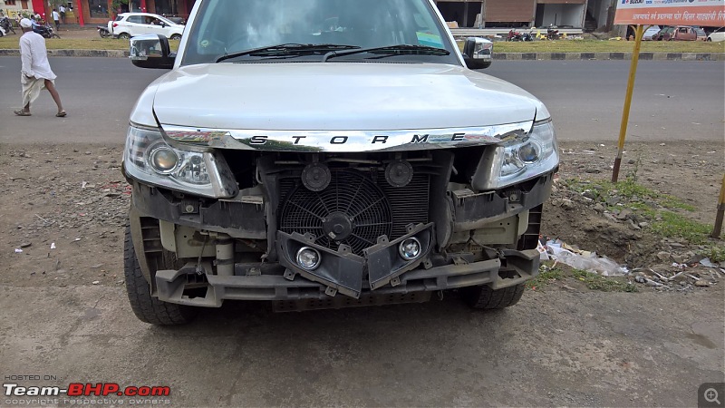

I have installed this to my Safari Storm. (jugad fit)
Its a high beam module.. works great.
But use a relay/wiring kit for it.
Auto Lighting thread : Post all queries about automobile lighting here-wp_20180808_14_15_54_pro-medium.jpg
Auto Lighting thread : Post all queries about automobile lighting here-wp_20180808_14_16_09_pro-medium.jpg
Auto Lighting thread : Post all queries about automobile lighting here-wp_20180808_14_16_14_pro-medium.jpg
Auto Lighting thread : Post all queries about automobile lighting here-img_20180807_173139519-medium.jpg
Auto Lighting thread : Post all queries about automobile lighting here-img_20180807_173149941-medium.jpg

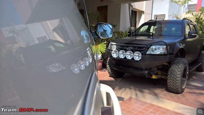

The Black vehicle is my XenonXT shown just for comparison of 90mm module with 4 Hella 700ff. (i was thinking to replace 700ffs with high beam module + hid )
Auto Lighting thread : Post all queries about automobile lighting here-wp_20170519_09_28_52_pro-small.jpg

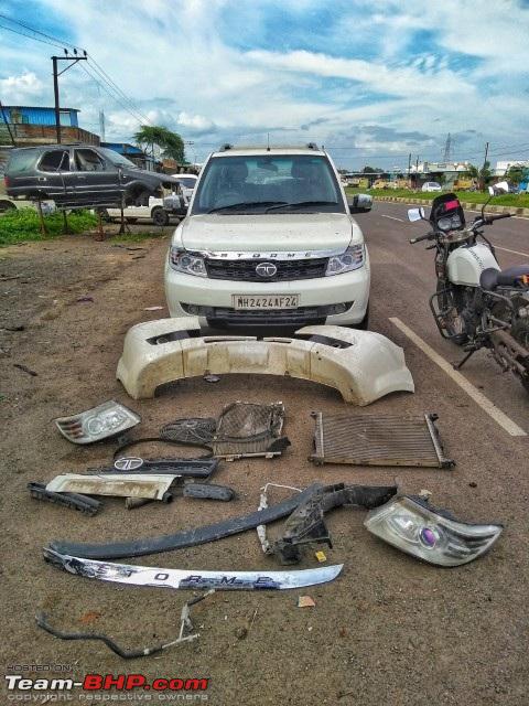

Dont have pis of lights in action as they are not working now. (safari had a small accident last month)
Auto Lighting thread : Post all queries about automobile lighting here-img_20190826_16071760501-small.jpeg
Ill post pics one i reconnect them.

Hey Jeepster,
That's one mean looking Xenon you got there. Would not want to see this looming in my rear view mirror.
Sorry to hear about the Safari. Hope nothing serious.
When you get a chance, please post a pic of the Hella lights only. Reviews on Amazon are not great. Chrome peeling off etc. Are you facing the same?
