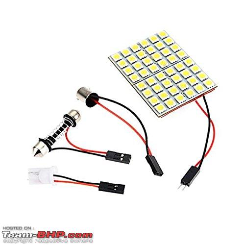

Old 5th November 2017, 23:24   #10789
arjithin's Avatar
Join Date: Aug 2011
Location: MEL/Chalakudy
Posts: 1,152
Thanked: 2,551 Times
Originally Posted by ramki067 View Post
Hey guys,
I want to replace my Stock interior bulb of my WagonR with an LED bulb. The stock bulb pic is in the link below. What type of bulb is it called and which is the best long lasting led bulb can I use?
https://ibb.co/kb1nSb
Many thanks,
Ramki
These are T10 base bulbs. There are multiple sizes for T10 base LEDs, you may want to first measure the size of the bulb and available space inside the dome light and buy accordingly.
Suggest to buy one like this which offers good light and has the flexibility.
If you are particular about getting a long lasting replacement LED, get a Philips or Osram one.
Auto Lighting thread : Post all queries about automobile lighting here-41oipluietl.jpg
arjithin is offline
