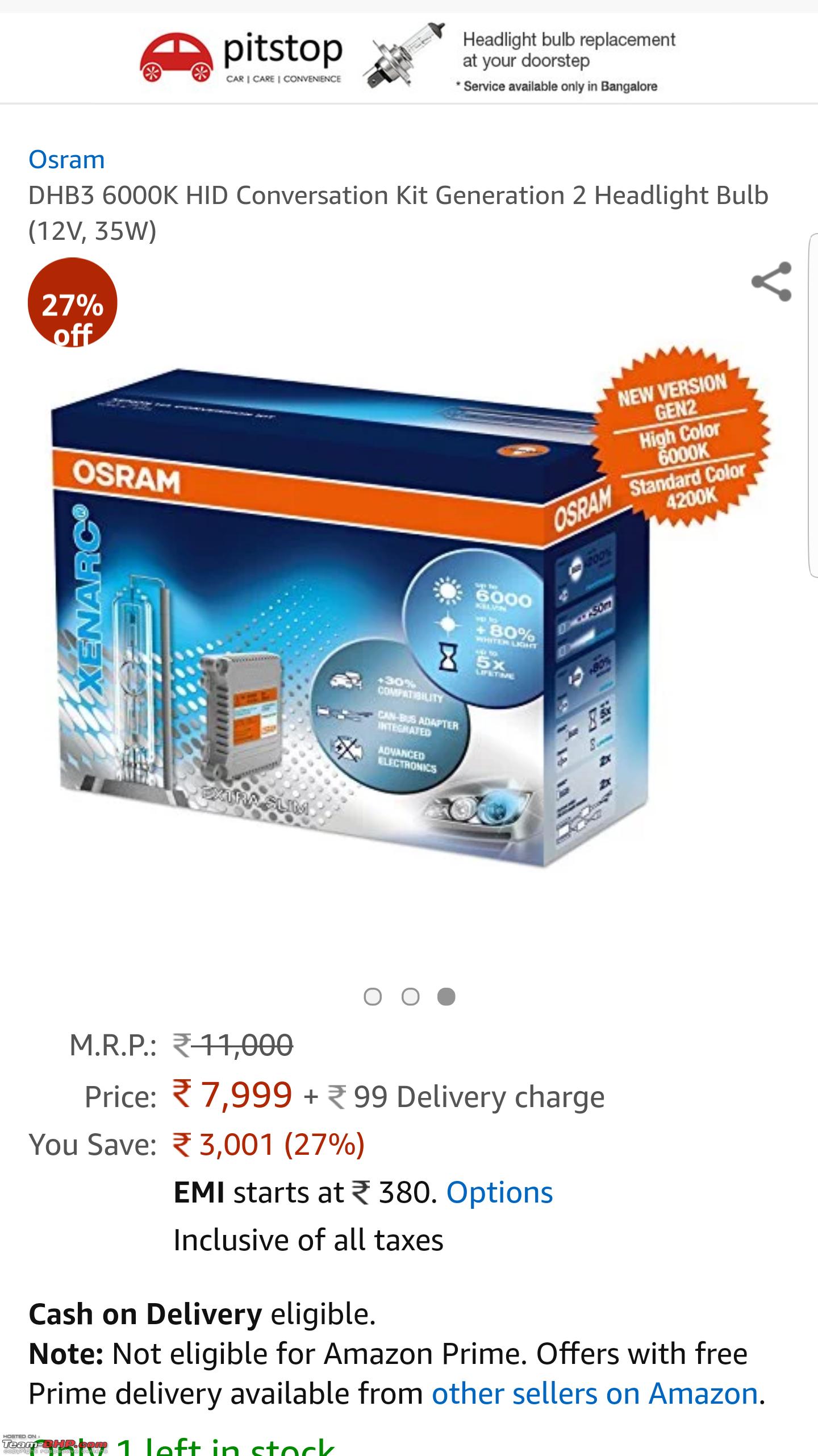

What are the differences between these two HID kits. I'm planning on using these in my endeavour for high beam.
Which do you guys suggest and is there a better option in HID or something other than HID?
Auto Lighting thread : Post all queries about automobile lighting here-20180205_160601.png
Auto Lighting thread : Post all queries about automobile lighting here-20180205_160539.png
The Gen 2 versions generate around 20% more light with the same 35W power consumption and are more Canbus Compatible compared to Gen 1 Variant. Also, the Gen 2 Ballasts are smaller in size than the Gen 1 version.
I would recommend getting the 4300K version of the Gen 2 type instead of the 6000K version as that will give you much better visibility.
