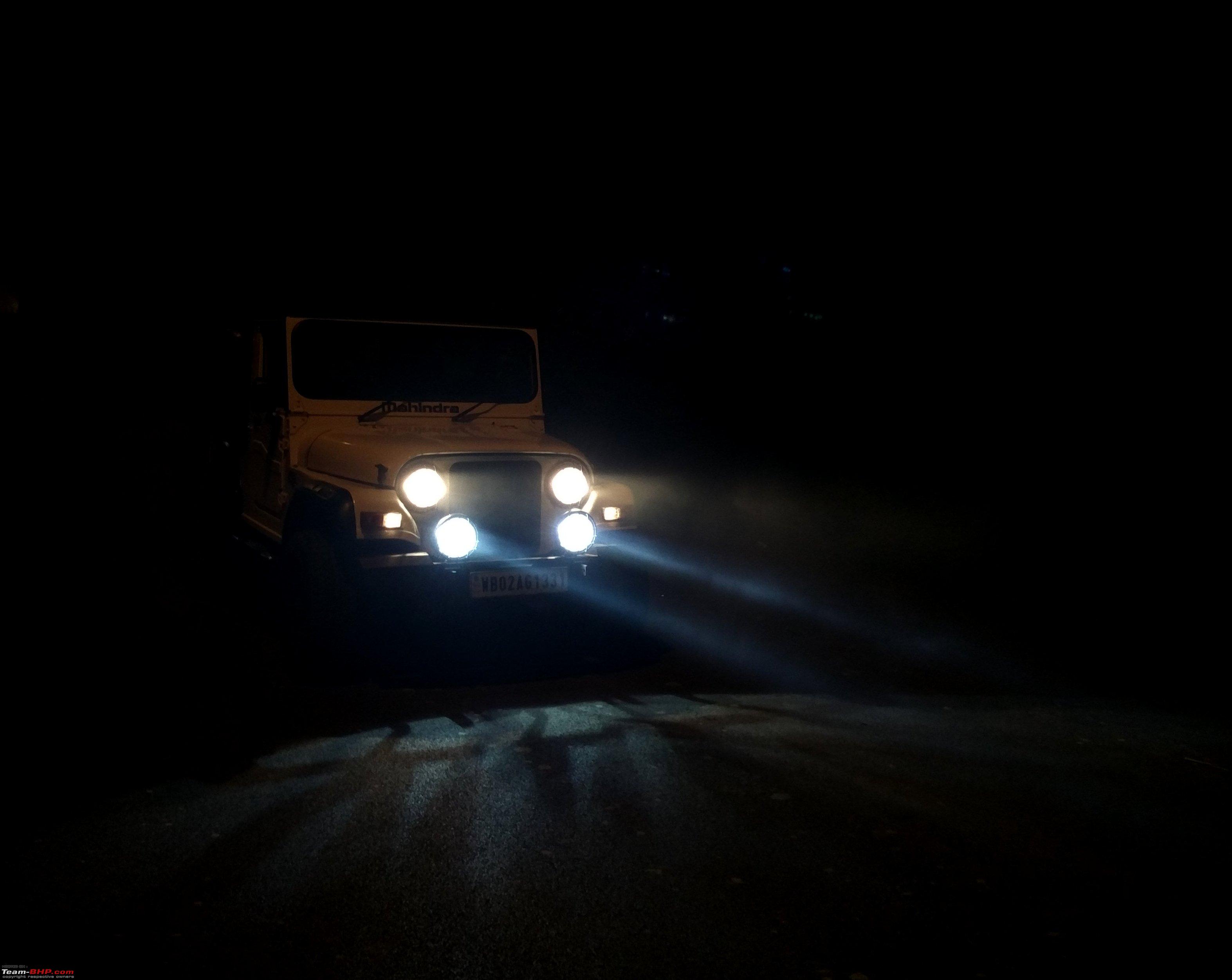

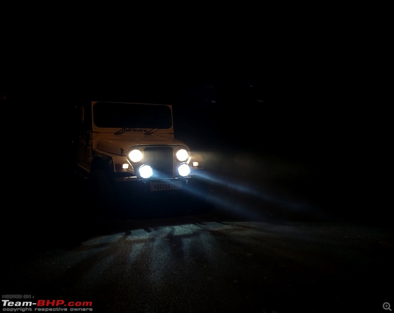

Installed KC Hilites Spot Beams on my Thar and quite happy with the result -
Auto Lighting thread : Post all queries about automobile lighting here-img_20171017_133132.jpg
Auto Lighting thread : Post all queries about automobile lighting here-img_20171027_021151.jpg
Auto Lighting thread : Post all queries about automobile lighting here-img_20171017_133346.jpg
