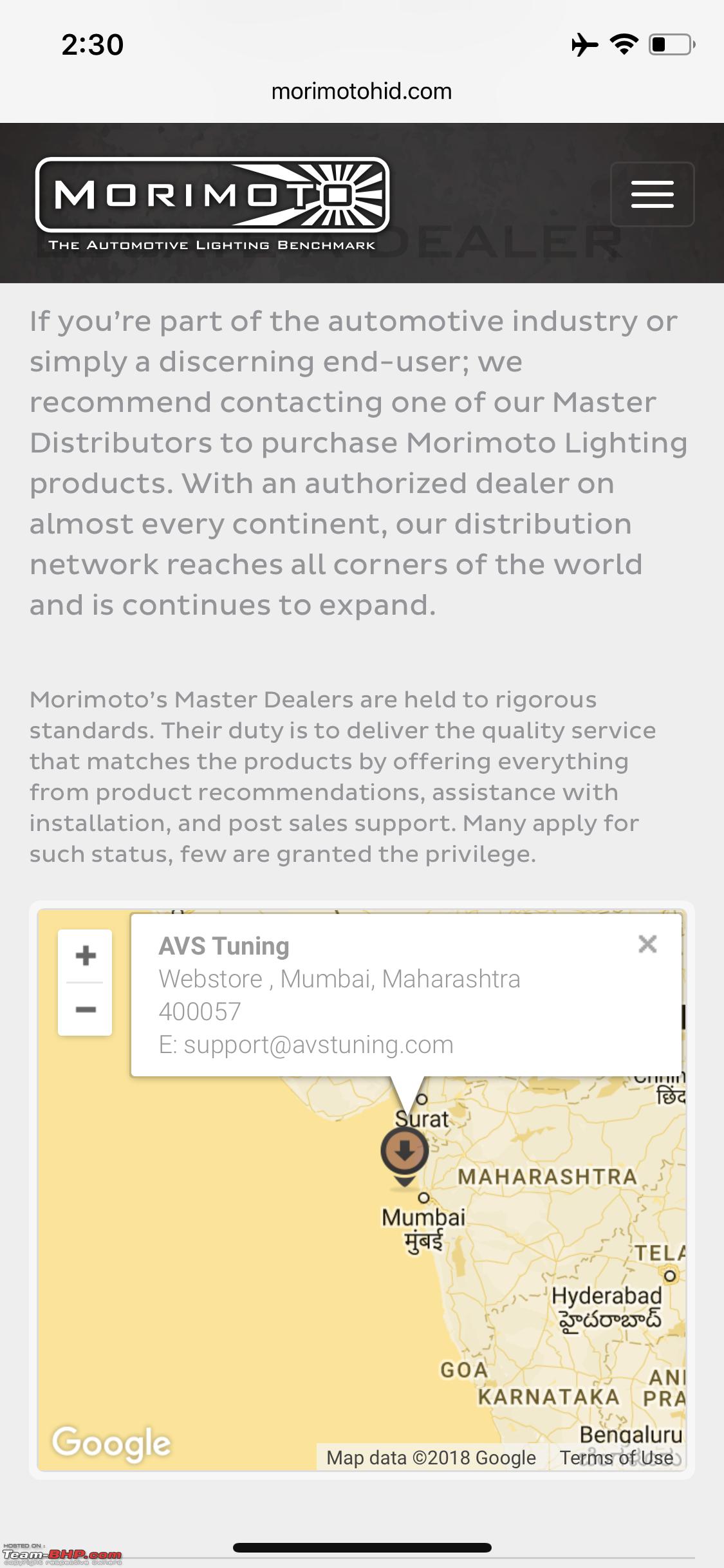

Where can I source genuine Morimoto in Mumbai?
Is AVS Tuning a good bet? I've heard that they have loads of duplicates floating around.
suku_patel_22 is offline
Old 12th February 2018, 14:35   #10918
AShubrah's Avatar
Join Date: Nov 2017
Location: DEL-IXW-PAT
Posts: 206
Thanked: 292 Times
AVS Tuning is an authentic dealer for genuine Morimoto products as per their website.
Auto Lighting thread : Post all queries about automobile lighting here-9972dddb41b24ac5a3f2145fdd5922dd.png
AShubrah is offline   (1) Thanks

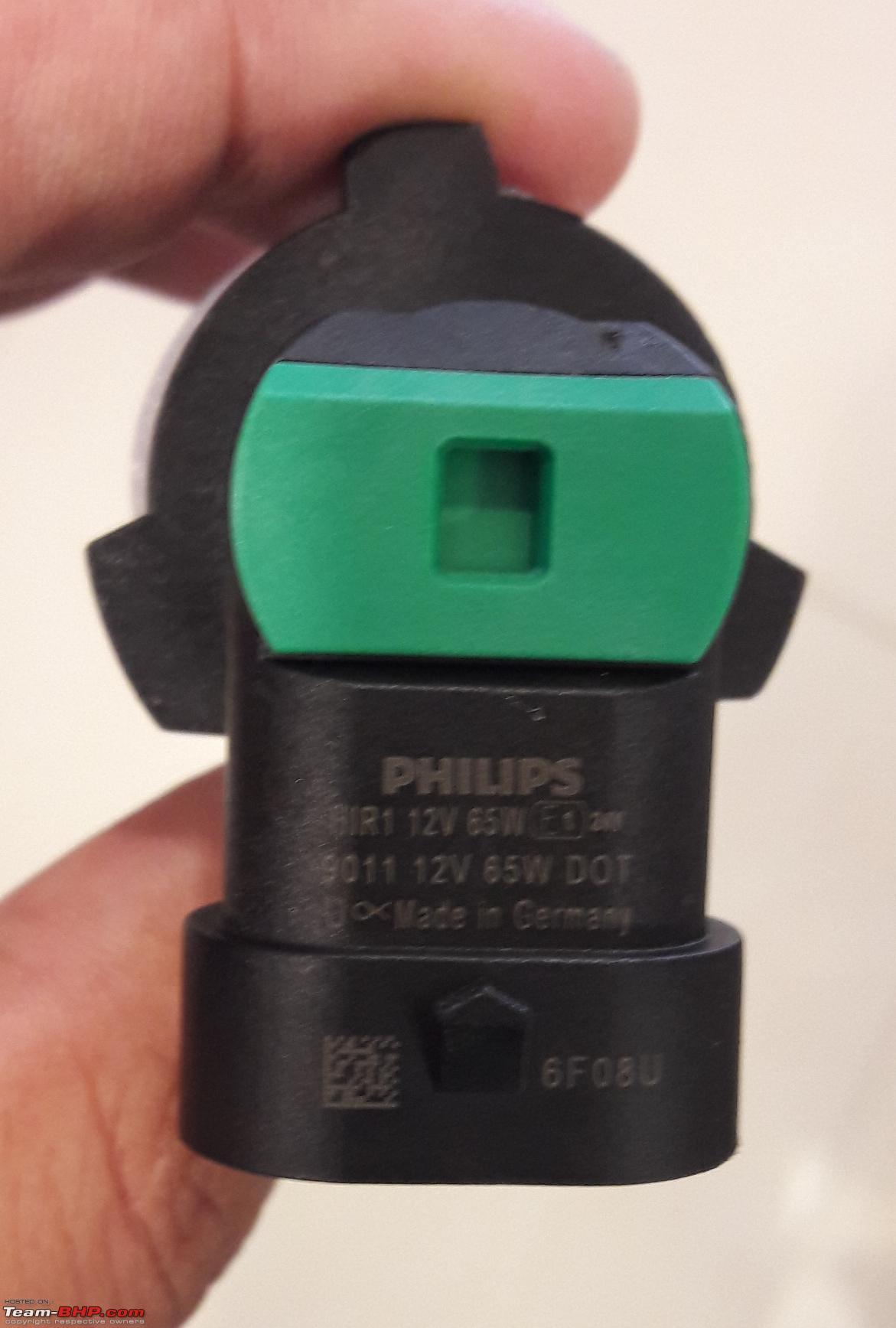

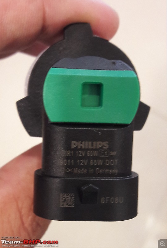

In my Jeep Compass, I have upgraded the headlight bulbs (9005) to Philips HIR B1 from Amazon.com (US) - they costed around 53USD landed to me in India. It is fairly easy to do and takes around 30 min to do. To get access to the bulbs you have to open the wheel liners as shown.
The bulbs need to be clipped on the top tab slightly with a nail clipper to fit.
These bulbs are made in Germany and with the same power consumption of 65W generate 2350 Lumens against the stock 1600 lumens. The light is also slightly whiter at 3000K CCT instead of the stock 2700K.
Auto Lighting thread : Post all queries about automobile lighting here-20180211_143735.jpg
Behemoth is offline   (1) Thanks
