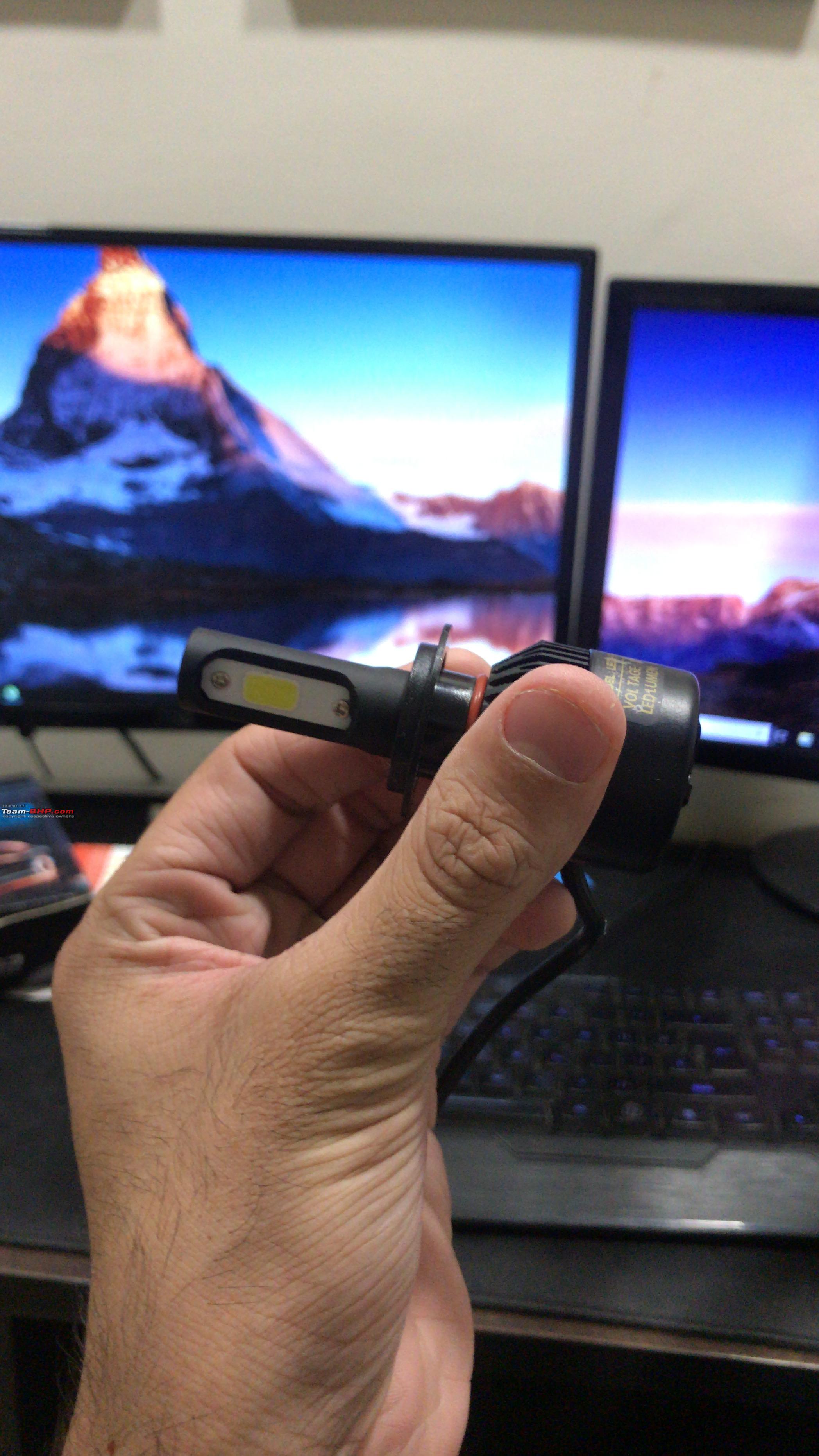

Ordered Chylay LED Bulbs from Aliexpress, H1 and H7.
The bulbs were delivered in 20 days, but majorly disappointing since the fitment for the ford is very tough, the throw is everywhere so the search still goes on for good set of VFM LED Bulbs.
Auto Lighting thread : Post all queries about automobile lighting here-3312d12c9643445fac01a3e43d7cf44c.jpg
Auto Lighting thread : Post all queries about automobile lighting here-6004817dbc8447b6a8745a2452034409-1.jpg
Auto Lighting thread : Post all queries about automobile lighting here-20d3bf00aae94d7d8a88f42dbb61599f.jpg
