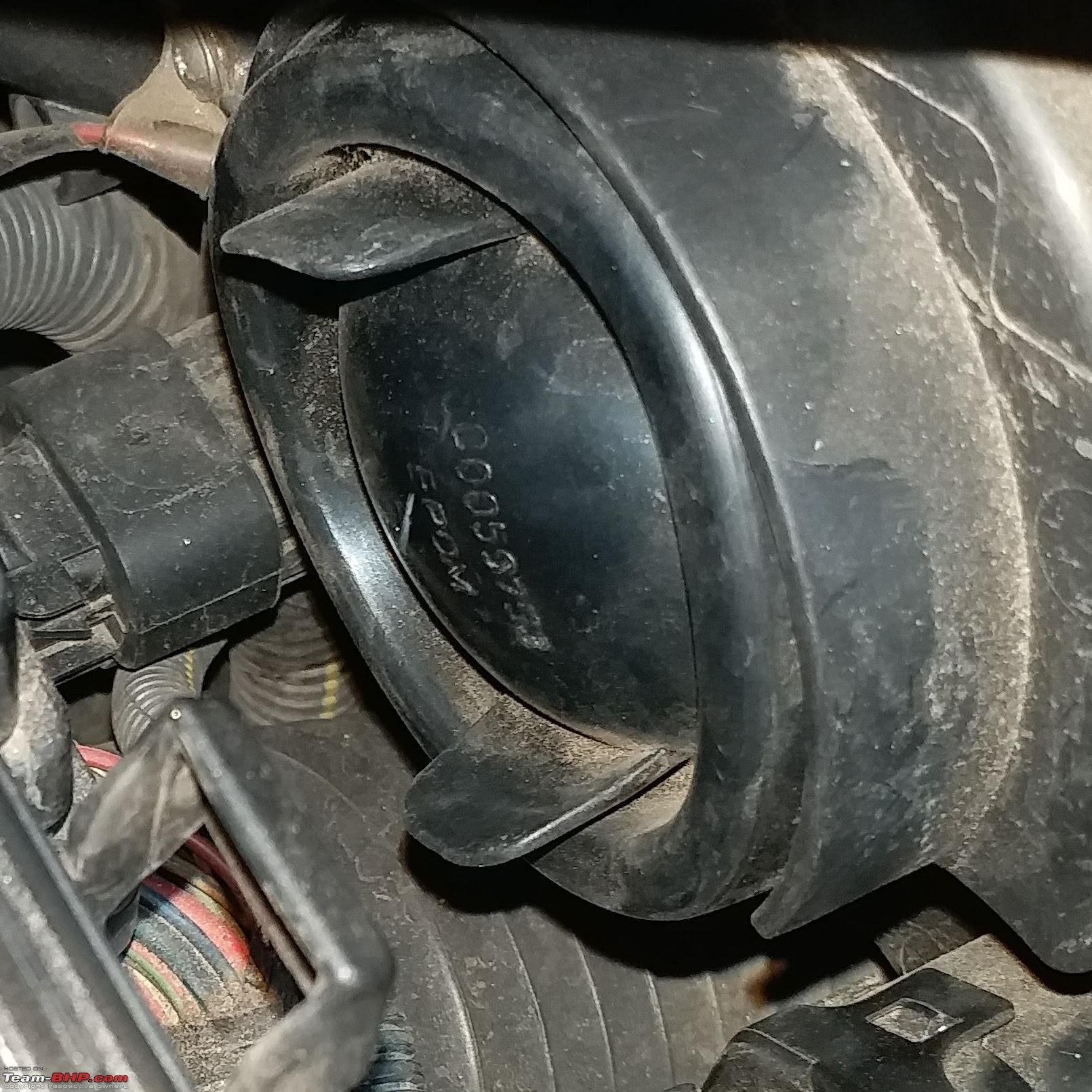

Was finally able to get the Ultinon LED's installed.
Went down to the Mahindra dealership at Maradu in Cochin to get it done.
They were initially a little unsure, but were professional enough to attempt placement in a discarded XUV headlight unit to determine whether the LED would fit. They were also a little worried about current draw.
However, once the installation work started, everything was a piece of cake. The only issue was the absolute lack of space in the XUV engine bay. Initially the tech thought he would have to dismount the entire headlight unit in order to fit the retaining clip around the LED, but I showed him how to separate the bulb (?) into two parts - the emitter itself with its spring loaded contacts; and the heatsink - which are attached by screwing the emitter into the heatsink.
Once the Heatsink is detached, the emitter can be installed just like a regular H7 Halogen bulb, after which the heatsink is screwed on again.
The new low profile heatsink design means that no modification whatsoever is required to be done to the projector dust cap, which fits right back in place just as with a regular bulb.
I had the LED's installed on the day prior to my night drive from Kottayam to Trivandrum so that in case there were any issues, I would have time to revert to the OE Halogens before having to drive at night with flaky lights.
Turns out my concerns were unwarranted. The lights work perfectly and put out a bright white beam that is well spread and comfortable to the eyes. My driver says he can actually see better with the LED's than with the OE Halogens. The reduction in wattage (The OE's are 55W, the Ultinon LED's are just 14W each) does not seem to equate to a reduction in beam quality. I am attaching a pic of the beam at night. The wall pic shows a very clean cut-off, and the road pic seems to show a very evenly spread beam. The experts may weigh in on this.
The High beams are the regular 55W OE Halogens at ~4300K, while the LED's are 6000K. The colour difference is clear in the combined beam wall pic. I may change the high beams to LED's too, later down the road, depending on my satisfaction with the low beams. I think I would also need to change the static bending lights to LED's, in order to have all the lights the same color. The only deterrent I see to this complete conversion to LEd's is the high cost, since I would like to use the known quantity that are Philips bulbs rather than go with no-name Chinese units.
I would also like expert opinion on the advisability of changing the front fog lights to 6000K LED's, vis a vis the penetration capability in foggy environments.

@pillainp; 6000K on a fog-lamp is a no go. In fact I put 3000K into my Civic and regret not doing to the 2700K. The warmer the better.

My friend, I hope you cleaned the LED's thoroughly before putting them in since the way it was held, as shown in PIC#1, they will go kaput in no time. If not, please take them out and clean it using an alcohol prep pad that is usually used to clean screen of mobile phones.
