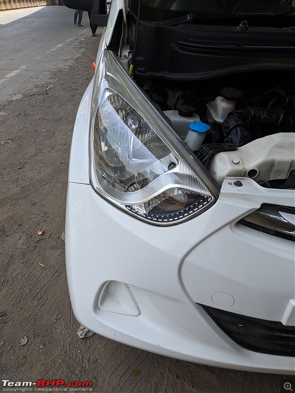

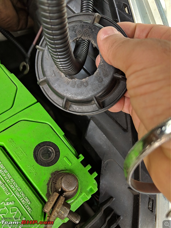

Philips Rally 100/90 & Philips Relay fitted in Eon.
So after a lot of consideration between Osram Nightbreaker & Philips X-tremevision-Plus-Halogen fellow BHPian "a4anurag" did come up with an unambiguous option of Philips Rally 100/90 & after a couple of online results, that is what I got.
Fitting is not much of a big deal.
Putting in Relay was a 5 mins job. However, a hole had to be made in the cap of the headlight assembly in so that the relay sockets would pass to the assembly in the HL box.
Following images are rather Self-Explanatory:
1. Removing the stock H4 Bulb from the hood! Auto Lighting thread : Post all queries about automobile lighting here-img_20180505_122916.jpg
2. The relay has 2 Bulb sockets on either side & only one plug that goes into the power socket present in the head.Auto Lighting thread : Post all queries about automobile lighting here-img_20180505_125057.jpg
3. A hole had to be made in the cap of the HL assembly for letting the heads of the relay pass through. Auto Lighting thread : Post all queries about automobile lighting here-img_20180505_125430.jpg
4. Properly confined & tied.Auto Lighting thread : Post all queries about automobile lighting here-img_20180505_130540.jpg
5. The brown wire is grounded. Here you can see the cap fixed back into the HL assembly & relay wires passing through it.Auto Lighting thread : Post all queries about automobile lighting here-img_20180505_130137.jpg
6. It's as of now sealed with electrical insulator tapes to prevent the dust from entering.

I don't have the OE lights pictures captured but I think it's needless to have it here. These upgraded lights themselves do the talking in a loud manner.
7. LOW Beam
Auto Lighting thread : Post all queries about automobile lighting here-img_20180505_203249.jpg
8. HIGH Beam
Auto Lighting thread : Post all queries about automobile lighting here-img_20180505_203255.jpg
