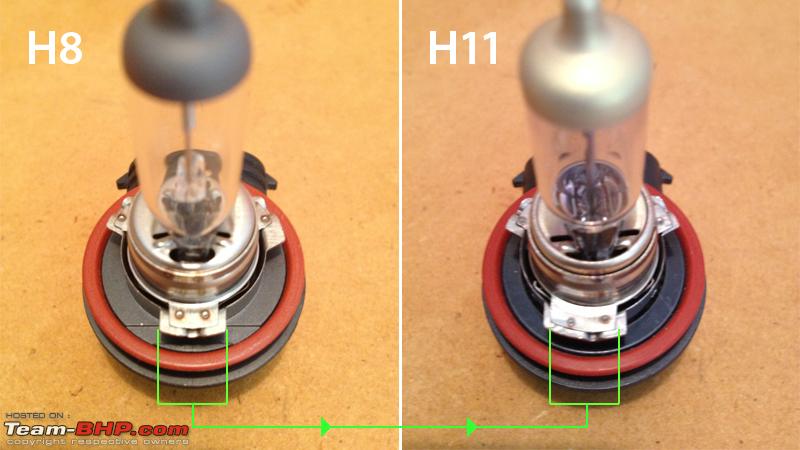

Its been 2 months since I have installed H11 (55w) for fog lamps in my Ertiga that earlier had H8 (35w).
The installation was plug and play like Anurag mentions but you might have to cut the outer plastic for one of the notches to accommodate and twist the bulb to fit in place. The right hand side one was easy while the left one required this.
Source
This above picture will make you understand where one might face issues. One option is to use a dremel and reduce that extra width too.
On the differences post installation -
Well, only marginal and I tested them by driving only with the fog lights on in a dark stretch and could notice around 20% better lighting but that's all.
This thread has detailed steps for the installation done in an Accord.
