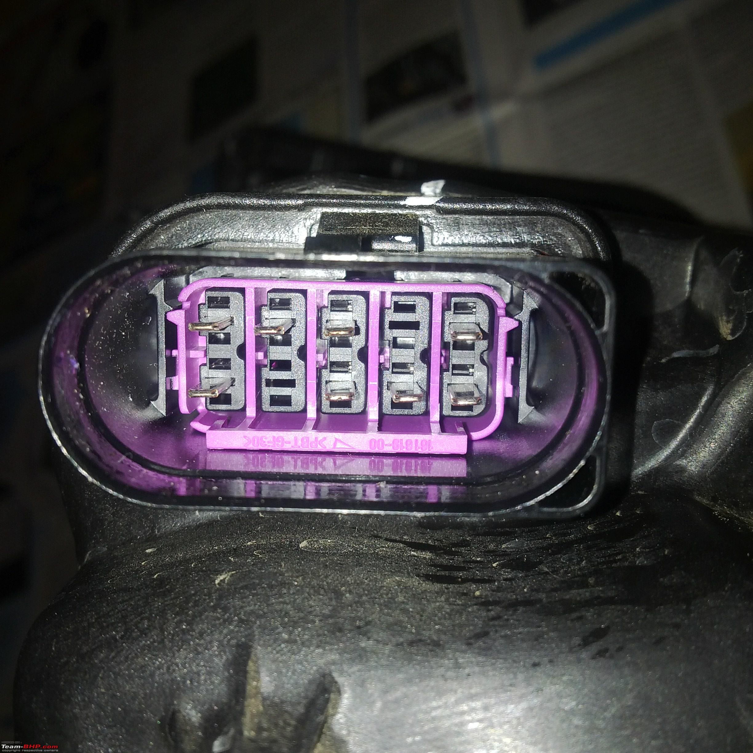

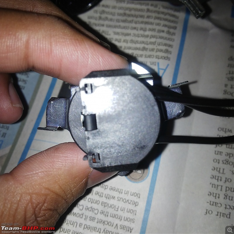

Hi,
I am planing to replace 55w H7 bulbs with 100/80w H7 bulb and use higher wattage headlight wiring kit. This is tricky because wiring for headlight in VW double barrel setup is internal. Single socket connects to the headlight unit and multiple wires from the socket are routed to high/low/park/signal bulb sockets.
I removed headlight to check quality of wires used for internal wiring and see if there is possibility of changing internal wires and H7 bulb holder.
Headlight Unit rear
Auto Lighting thread : Post all queries about automobile lighting here-headlightrear.jpg
Headlight main socket (8 pins)
Auto Lighting thread : Post all queries about automobile lighting here-headlightsocket.jpg
Internal H7 Socket : You will notice two parallel wires to single terminal. This is same for low and high beam
Auto Lighting thread : Post all queries about automobile lighting here-socketh7.jpg
Internal H7 socket
Auto Lighting thread : Post all queries about automobile lighting here-h7socket.jpg
Internal wiring
All wires used within headlight unit are black, hence we need multimeter to identify which pin leads to which bulb. I was not able to find wiring schematic for headlight internal wiring. These wires look too thin to support 80/100w bulbs.
Auto Lighting thread : Post all queries about automobile lighting here-internal-wiring.jpg
I am not sure how to replace existing wires thru the existing socket. Easier and crude way would be to cut/splice existing wires and route higher gauge wire through the rubber cup but I do not want to choose this option.
Regards.
Look carefully, you will a fully black and a black with a grey streak. For 80/100 you have to add an external relay and wiring.
sgiitk is offline

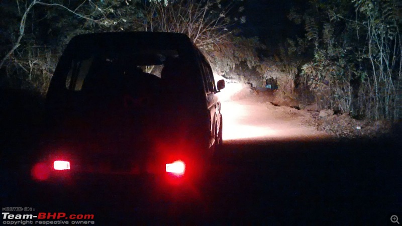

Many people (as a show off) go for 6000K or even 8000 / 10,000K bulbs. It is these which cause problems. I have 3000K 55W HID in my fogs, and my son has a 4300K HID system in his City. Neither of us have faced any colour / haze issues.
Simple case of Physics / Optics / Spectrum. White light vs Perspective Yellow / Yellowish light frequency.
After 4300K, the 6000K HID light is a pain to use on highways and in inclement weather. Self had one, and had to replace with regular halogen system to suit my long distance travel, prolonged night driving requirement, harsh terrain and inclement weather conditions that I travel in. With personal experience, I can vouch for it.
