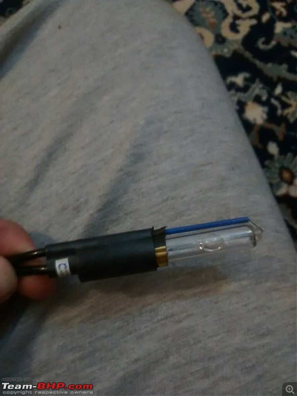

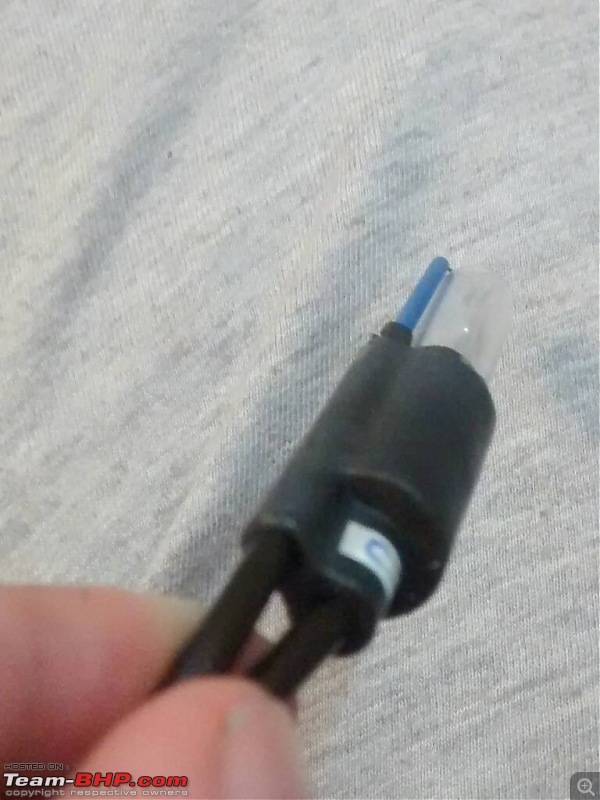

H anything. ! check some pics
Auto Lighting thread : Post all queries about automobile lighting here-1449686377895.jpg
Auto Lighting thread : Post all queries about automobile lighting here-1449686404778.jpgAuto Lighting thread : Post all queries about automobile lighting here-1449686430034.jpg
Auto Lighting thread : Post all queries about automobile lighting here-1449686292571.jpg
Auto Lighting thread : Post all queries about automobile lighting here-1449686318577.jpg
Auto Lighting thread : Post all queries about automobile lighting here-1449686334625.jpg

These are the generic HiD bulbs DSx where x may be 1 or 2 or something else. These should be easily available.
As I thought.
These are the ones you want. They are some proprietary things, no standard base.
http://www.aliexpress.com/item/12V-3...024109766.html
mayankk is offline   (1) Thanks
Not exactly, they are standard HID bulbs used in most projectors. You should get them quite easily.
Not really. They are not any DSx bulbs, and I could only source them off of DX and Ali after a lot jaddo-jahad.Only a couple of listings there as well.
I have them in two pairs of projectors, both sets ali sourced, and it has been a pain. In india, they are impossible to source from your neighborhood guys.
Are they working fine? I saw the pics. I think they will fit perfectly. Going to order right away!
