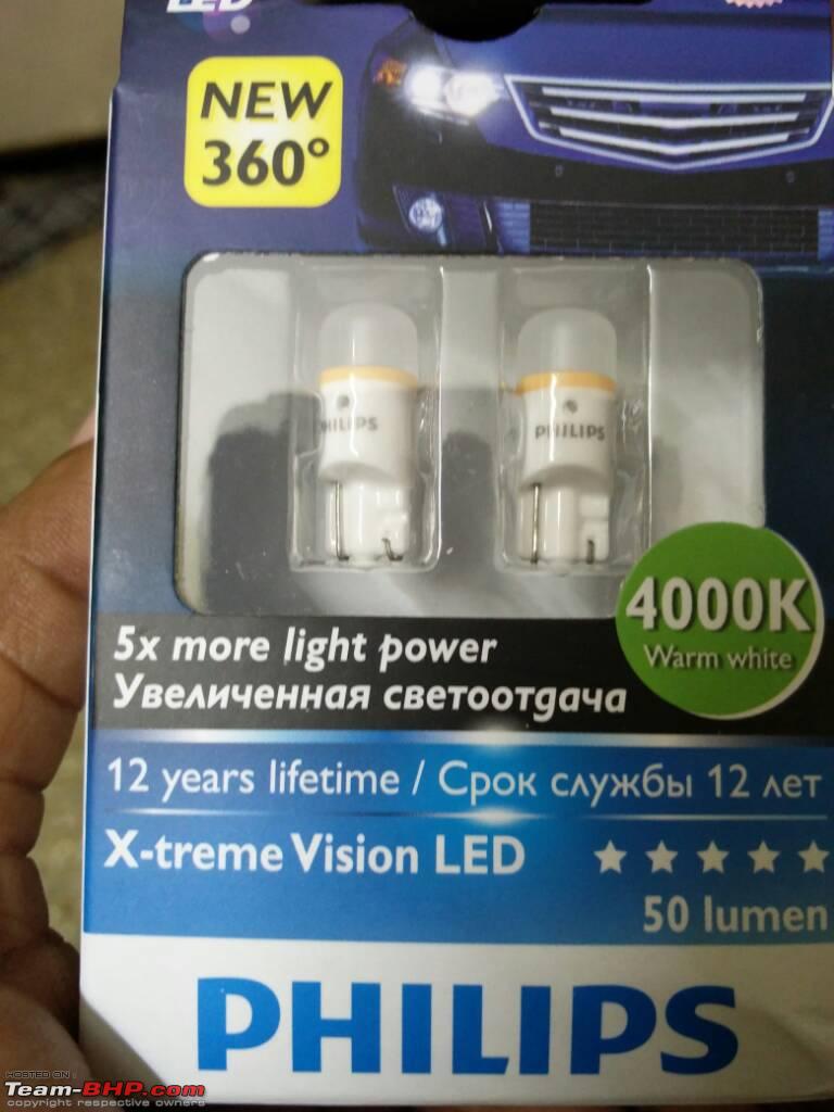

I would like to replace the pilot lamp which is a T10 w5w bulb to the OSRAM Cool White LED Bulbs. I am having difficulty to remove the T10. I tried to remove them by pulling the wire, no use. I tried rotating them. They rotate freely. No use. Any suggestions?

Is the bulb holder freely rotating? Please avoid pulling the wire. Try dodging sideways to see if that releases from the mount. You'll need to be careful because if any over weight applied might damage the unit.
Why don't you try Philips 360° vision 4000k warm light T10 Led(w5w)? It's awesome and match close to your headlight color temperature. Cool white will be more towards bluish tinge. Check the pics I have attached for your reference. They are not yellow they are not white but in between.

Hi bro, actually I am using OSRAM nightbreaker plus bulbs in my i20. They are 4300k. Almost white but with a yellow hue. I want to cover up that. So installing these. These leds also produce 50LM like your philips leds but color is more whitish.
I tried to wiggle it, no use. How you changed the pilots in your car?

The bulb holder locking might differ from vehicle to vehicle. First I located the pilot lamp socket, all I had to do is twist to find which was it is being tightened and release slowly. If you're a DIY person can do with little care, or any garage mechanic would help. In your case, I would suggest you visit garage in case if you finding it challenging to remove the pilot lamps.
As i recall, Osram Night breaker Plus Unlimited(latest from Osram) produces only 3900k as I read specs. So having 4000k pilot led will be close enough is my thought unless you still wanted cool white LEDs.
